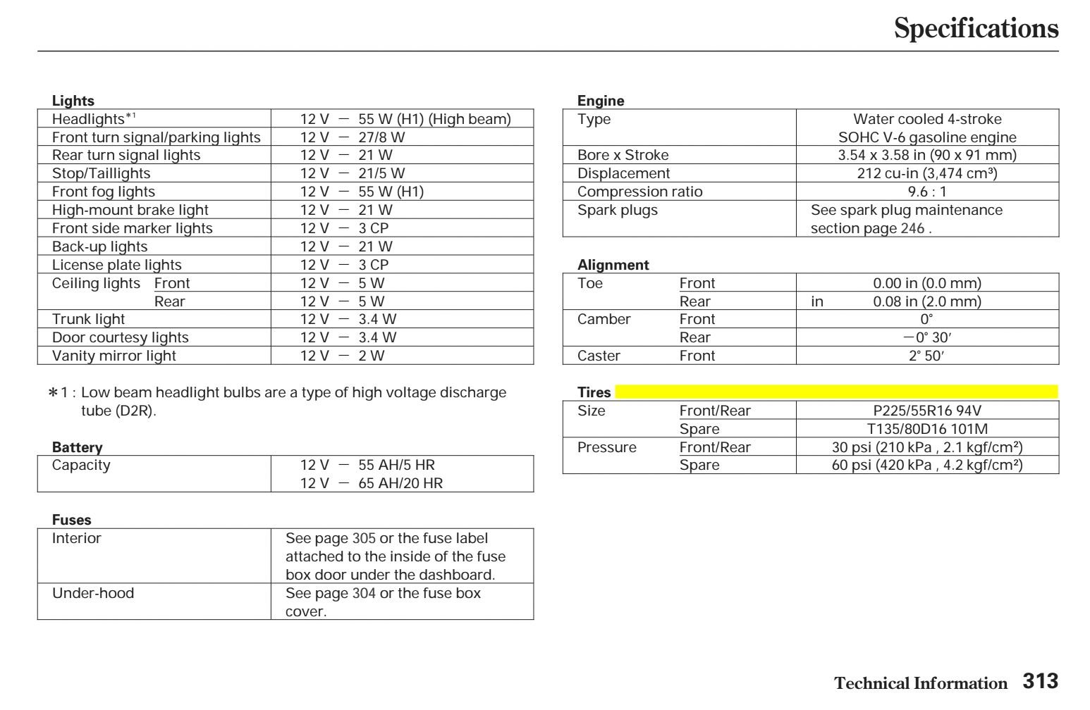

Acura00RL, Thanks for taking the time to reply. For over 20 years I've been using P225/55R16 in accordance with page 313 of the 2002 RL Owners Manual (page copy attached).
On page 299 of the 2000 RL Owners Manual it lists the P215/60R16.
Has anyone put the 205/60R16 on their stock RL wheels? I've read that peeps put the TL wheels on their RL and my 2003 TL stock wheels have 205/60R16 tires.
