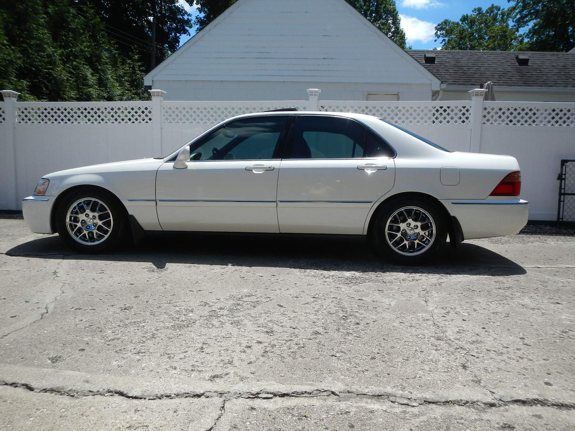

Parts availability for older First Gen RL's gets worse every year however, you can find parts for them with online Acura parts dealers, ebay, Amazon.com, and now most junkyards (and pick-a-parts)of old are all online now. You can Google used online auto salvage and find places that will either have what your looking for and some that will even do a nation-wide search for you. A 2002 RL for $650.00 is a steal and worth repairing, good luck. My 2000 with 111k miles below.
