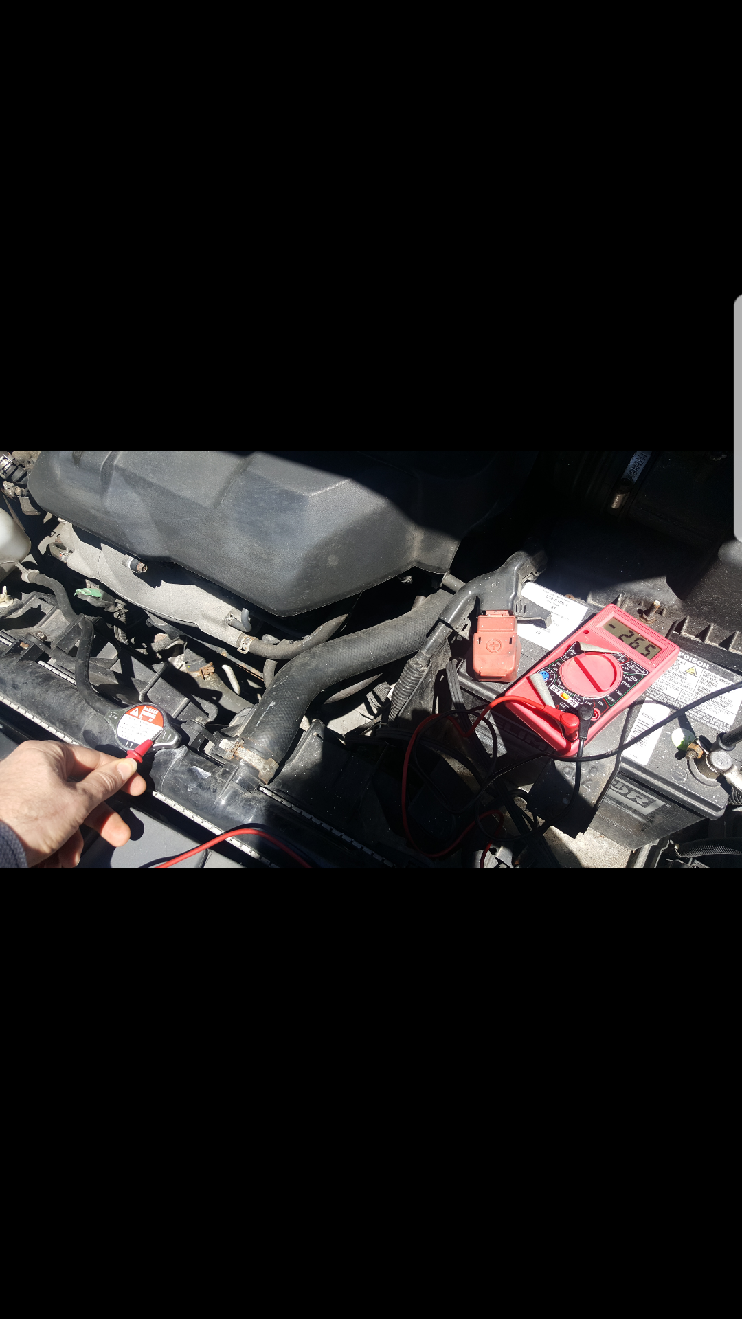

Various reasons could eventually lead to this: salt, improper factory installation, electrolysis, coolant not replaced, overheating, excessive pressure from blown head gasket, etc.
Personally I think it is unavoidable due to stray voltage through the coolant over time. So I just did three drain and refill with distilled water, then replaced with fresh coolant again, just 11 months since last one also with fresh coolant. I will probably call it annual summer maintenance.
Bought a cheap unit from eBay for <100U$, then had dealer order the lower hose, it did not <want> to "quick release" after all.
Turns out it was a good call after all, found a radiator pinhole leak on its surface facing the A.C., no way could be found without at least pulling it.
Took advantage and bypassed the cooler/warmer portion. For the record I would NOT RECOMMEND the bypass on any RDX doing daily idling or numerous stop&go. The cooler transfers heat from transmission to the radiator coolant much easier during these conditions (think 100x easier as its liquid to liquid through the purpose built OEM internal part). For these situations the OEM might be a better choice due to its elaborate internal design of the INSIDE of the warmer/cooler.
For those with the bypass keep an eye on the temperature during idling, preferably with OBD2 application for exact temperature reading. In my case idling using distilled water the thermostat seemed to open just over 200F, and then later the temperature rise activated the radiator fan at 212-213F.
When exact temperature is not available, consider activating both fans via AC control-any time you expect be idling for a long time. In such cases 5 minute of combined idling, stop&go driving might be considered too long time.
I used transparent silicone and sealed-covered the washer. It probably won't matter in the end, but why not, given the easy access at the time.
With this setup I will just keep testing for stray voltage between radiator and battery at idling and off. When its high again will use distilled water for three flushes and coolant replacement. This is likely to be the last radiator needed on my car, 2008 base at 265k km.
HTH

Stray voltage through Rdx 2008 1 year old aftermarket radiator with less than 1 year old fresh coolant.
Originally Posted by Tomtwtwtw
The issue that blends transmission fluid with coolant is generally an internal radiator failure, and most likely caused by old coolant. If you stay on top of your coolant flushes, it's highly unlikely that this will happen. Coolant becomes corrosive over time as it breaks down, and age is a much larger factor than mileage in this case. Those running around with 10 year old coolant because their car is still low on miles are probably living on borrowed time when it comes to this issue happening.
Certainly multifaceted. In my case 1 year old radiator with less than 1 year old coolant (refilled after 3 drain refill with distilled water), had already exhibited stray voltage of 0.2xx V with engine off. I just redid it and will retest in a few weeks time. What is your radiator stray voltage?

Take the cap off and put the test probe inside touching only the coolant.
Crank up and check again.
Then check voltage at the battery while running to see how the alternator and voltage regulator are doing.

Indeed, last year I tested like you said. I had practically nil voltage probing with just the fresh coolant vs the battery terminal, few weeks after installing the new radiator, engine off.
Obviously IF the coolant remained non-conductive after one year, even assuming a different, unidentified source of stray voltage from the engine, it would not be enabled and would not reach the radiator, probably not be a major concern to me. Hence my sharing the experience why after quick testing, I had to change a one year old fluid in a new aftermarket RDX radiator together with digital reading of temperature necessary to activate the radiator fan in my car.
During this past year my MID temperature display did go from seven to eight tiny bars, only twice - just a few seconds each time, and I am sure would not have seen it if I did not watch for it to prevent overheating.
After all I also

Yeah try direct to the coolant. And maybe try a new meter.
I checked this with mine and it starts out appearing like it is reading but it quickly jumps to like 150 mV and keeps declining. I realized if I removed the probe from the coolant it was continuing the same pattern. No reading really.
Interestingly though, I got 0.597v going directly to the external part of the radiator core. 0.000v directly to the engine.

Was it idling or off? How old is your coolant? Was the 0v engine reading to the negative battery post or to the radiator coolant?
Maybe the 0.597v was impacted by the paint layer of the radiator, though I would think it would reduce the value not increase it...
I don't mind spending $10 on a new meter to reconfirm reading. I do verify the meter leads crosstouching while on the smallest resistance scale, so feel my numbers are real in my case.
Testing to the outside of the cap allows more convenient expanded test timing, reading during or immediately after trips, think running pressurized conditions. I agree the actual number is somewhat inflated by the cap itself, even more so when cap really old, good only for a trend. Mine was new last year together with the radiator.
Ask and you shall receive, 146mV. Idling alternator voltage stable@14.3V.
Engine ground loop was replaced last year too, 6 gauge iirc, off the engine mount.
