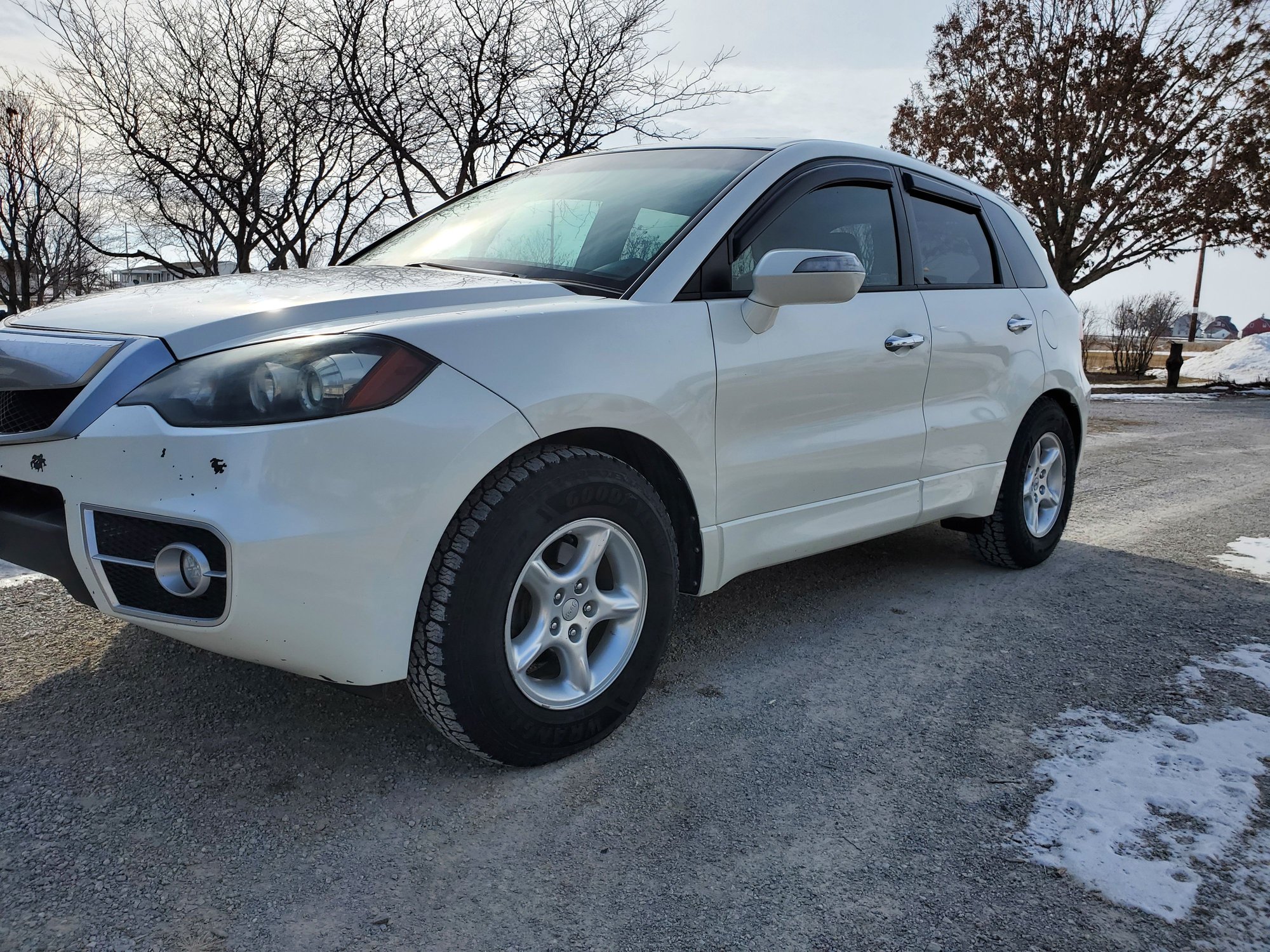

I used 20mm spacers and like how it improved the stance with the factory wheels. Also use them with my winter tires for enough clearance on the brakes with 16" jeep rims and 225/75/r16 goodyear workhorse all terrains.

​They are 16" aluminum rims off a 2000 wrangler. Shopped around at a few junk yards for this set. Just have to make sure lug pattern is the same and the hub bore is the same or larger on new wheels. I had to use hubcentric rings for proper fitment. Rides surprisingly smooth and quiet for knobby tires. On the interstate car feels a bit looser in its track but gain traction on the backroads
