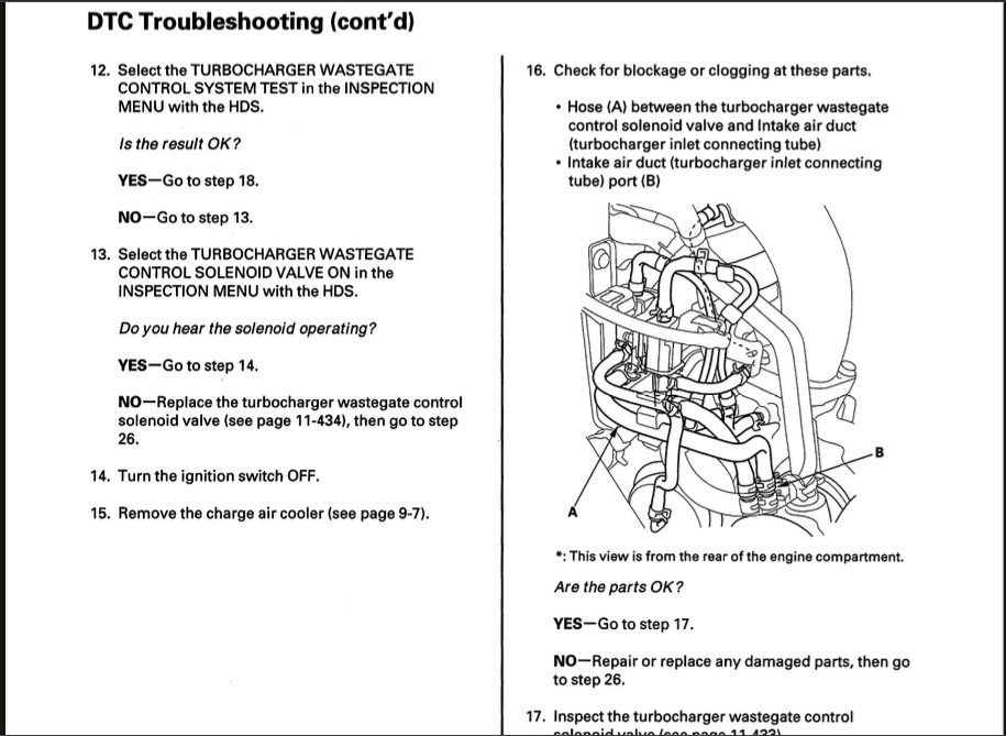

I was wondering if anyone could recommend a scan tool for the 1G RDX that can perform the tests/functions shown in the pictures I posted below. I have the dreaded P2263 code, and I would like to perform as much of the diagnosis myself - turbocharger boost system tests, turbocharger solenoid valve turning on via the inspection menu, etc. The actuator does not appear worn from the over-the-hood view (it could be worn below or the pin worn, but removing the turbo is the last resort). I know these tests were done under HDS, but I would like something more modern. I've budgeted up to 600 USD.

This will do most of what you want with 07-12 rdx
The foxwell not the hondata lol. I chased the 2263 code myself. It ended up being o2 sensors for me. I changed the 5 turbo actuators, the turbo, I have a custom turbo back exhaust "so the factory converter was prolly bad too" .
If you change the o2s make sure to use the OEM ones or you'll throw codes.
Good luck on the fix and the turbo itself " if needed" is easy if your mechanically inclined. Foxwell nt510 elite - 120$ roughly and will perform the solenoid / actuator tests.

The Foxwell can actuate those solenoids?
I have both NT510 and a Launch Creader Elite... the latter does a lot of special Honda functions but can't actuate the wastegate or bypass valve solenoids unfortunately. I looked thru every menu last night.
I'll check my NT510 when I get home... it's a great tool for Honda and Acura in general, but I'd be surprised if it has a module for the turbo solenoids.

Sorry for the late reply, I know the rdx stuff can be nerve racking. So I found out my o2 sensors were bad after replacing, all the turbo solenoids, the turbo, pcv valve, and anything turbo related. Of course I did the turbo last and then decided I'm going to replace these o2 sensors too. I don't have a converter I run turbo back catless.... So I couldn't tell you if the converter was bad too.
As for the scan tool it does do the turbo solenoid test. If you need pic of it connected and the option I can run through it.
Yeah the nt510 elite has the option it's deep in the menu, but you run the test from the live data section of the tool. I can post pics of you guys need and I'm sorry for replying 2 weeks later.
