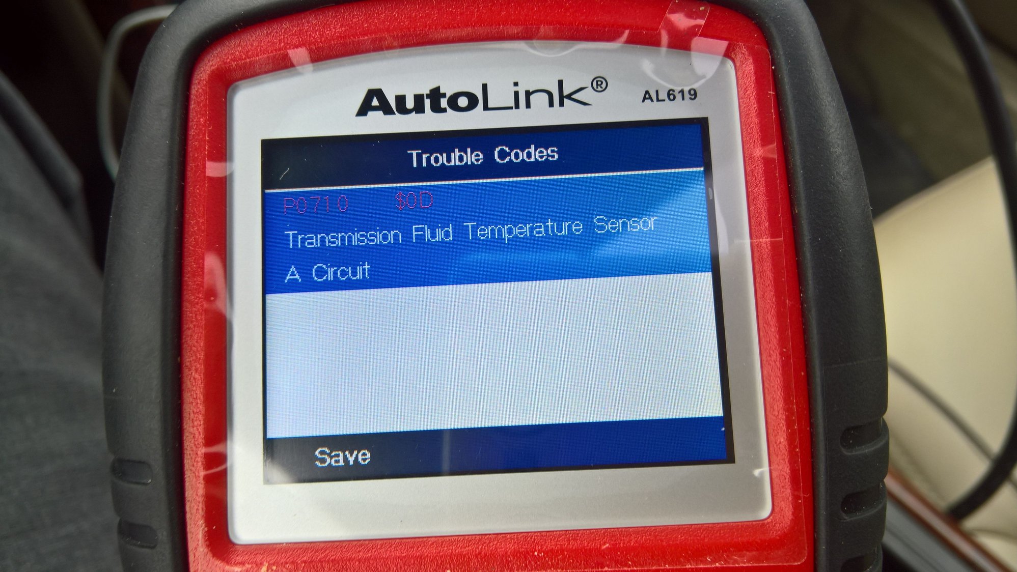

a slightly cheaper version of it is the Autel AL619 but it doesn't read as many things like body control module codes. this one was 140$ if i remember...
here is a photo of me last week scanning my 02 TL flashing D light.
