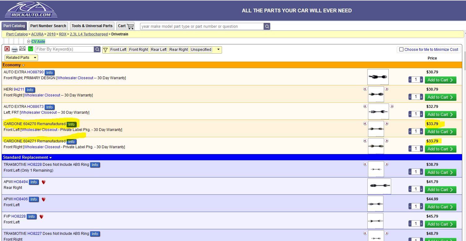

Last month Rock auto had RDX CV joints on clearance for about $35. They were refurbished ones. I think that is the way to go. I think CV joints are pretty complex because each joint needs to go multiple ways and the aftermarkets have trouble with the precision (But just my opinion) OEM's are REALLY pricey; Often times 5 X more expensive.
I think a refurbished OEM shaft is the way to go.
I just checked, they still have them. I guess it sometimes pays off to have a low production car

They are not normally that inexpensive. Rockauto bought them as a closeout from another parts company.
