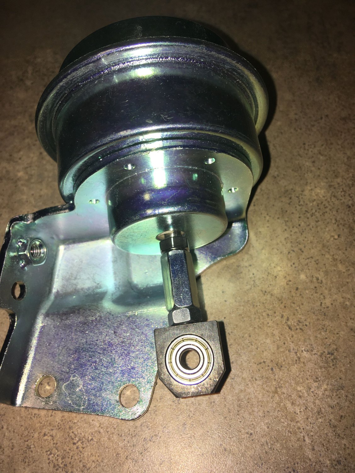

Originally Posted by Dtheod
I posted a SHAWD fix...and this guy decided to attach a link saying to buy the actuator from somewhere else. Turbopark sells an original part. Thats why it costs between $200-$240. If you could buy the same part as a genuine Mitsubishi turbo actuator for $54. Turbopark would not be in business. Look at the link, it is a cheap part, it is not calibrated. No markings on the adjuster nut. In addition it will not work or last. Take a look at the one from turbopark. It is night and day. If you want to buy a part for $54 and think it will work. Go ahead. I fixed my car already. And I used the actuator from turbopark.
Sorry if I offended you. I bought what I linked. I don't have the code, but bought it in advance and I thought it would be a good idea to replace the 17 year old billows. I know the one I got is designed to be the wear point rather than the pivot. Personally, I'm going with a ball bearing insert so wear won't be a problem and adjusting it won't be an issue because I'll have the turbo on the bench.
So you had the bearing inserted as a custom job then?
No. It's a replacement bearing for skateboard wheels. It just happens to be the right size, and readily available.
