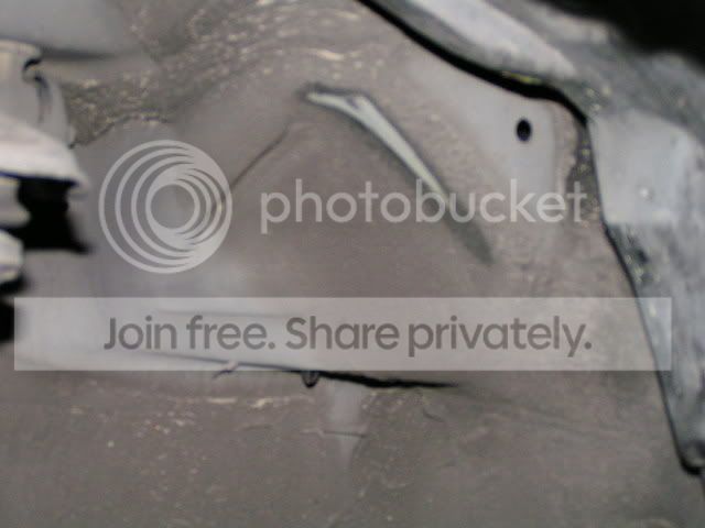

any oppinions on how to fix this?
today i was putting on my new break kit and i noticed that my left front tire was worn down. i alredy have a camber kit but im not quite sure if thats my problem. so before i do something that might cost me an arm and a leg can someone let me know what they think the problem might be.

This is a consequence of lowering and increasing tire size, if I understand your signature line. Fix is to reverse the changes and return to original specs.
good luck

Yeah looks like your tires are a bit too big and wide. Or at least you are too low for their size. Odd that you ate that much tire and never smelled the toasted rubber... Then again I guess if nothing is on the other side of that piece you could just hammer it in.
