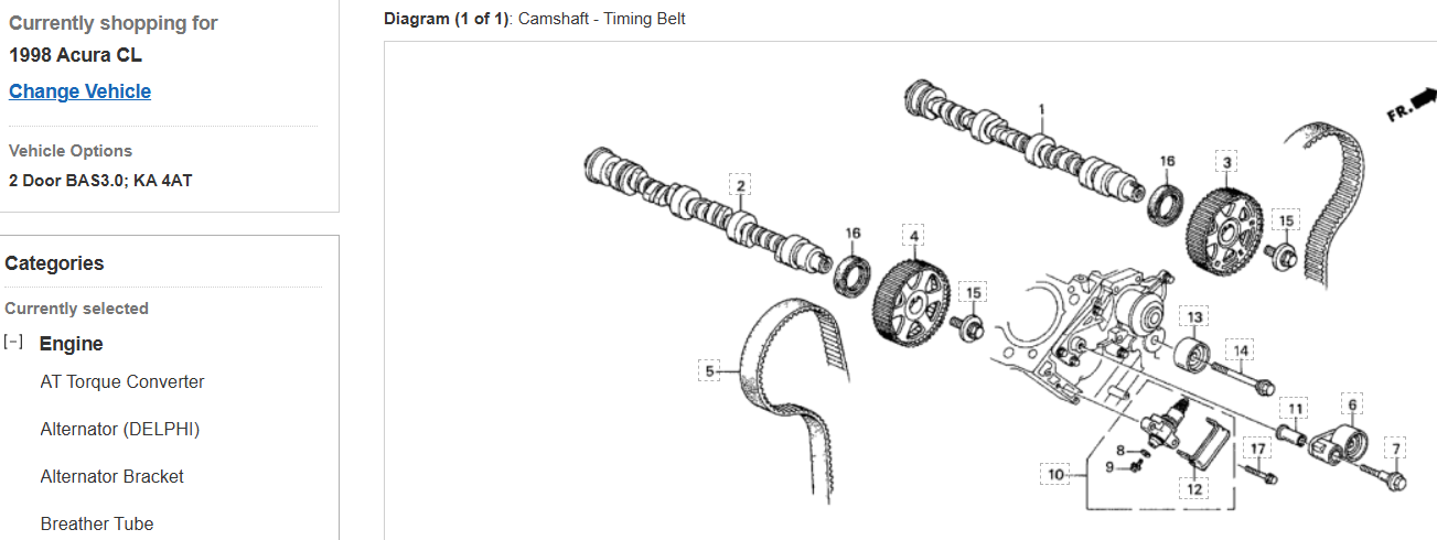

Is the timing belt still intact, #5 below?

Haven’t checked I didn’t think it would affect the instrument cluster? As of right now it’s not cranking or starting. I can bump the starter an it turns over headlights, heat, everything else seems to be fine
