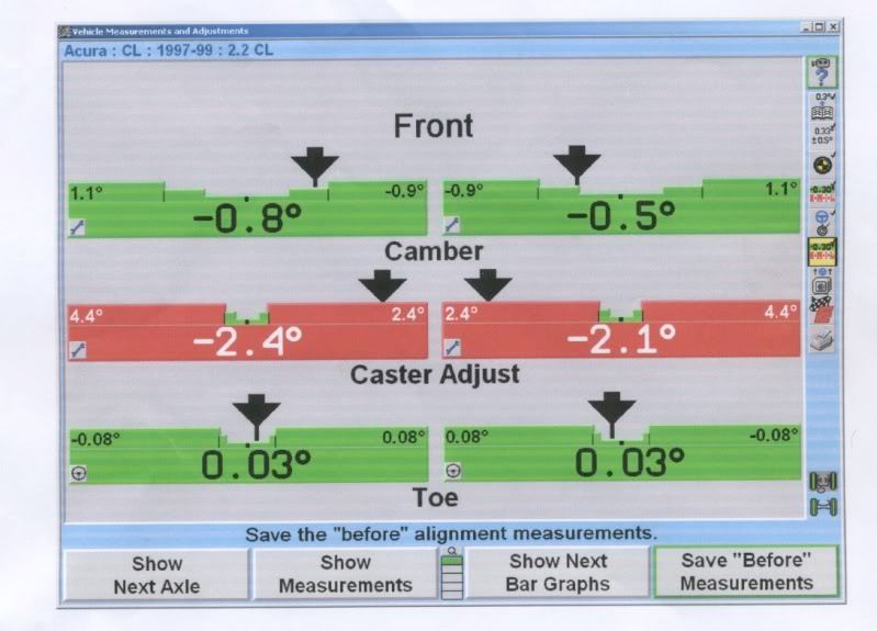

So i brought the car back to the shop and they told me the computer read thet everything was in order and they have absolutely no idea why the tires wore out like that. I don't know what to do, I can't afford new tires right now, so I have to put on my goddamn 18's again. Fuck.
Chris please move this out to the general 1st gen forum so more people can see this, I need as much insight as possible as to what the issue could be...
bullshit. anyone working at an Actual Alignment shop should be able to tell you whats wrong. sounds like they didnt align you right after your install, and now your tires are fucked and its their fault. and they are saying everything is normal just to cover it up

The only possible explanation they came up with is that the tire has wear that I was unaware of and it only worsened. But they changed me back to my 18's free of charge because i couldn't afford any new tires...
but they said my caster was all fucked up, but that hardly affects tire wear... anywhere here is the readout
and since i put the 18's back on, there is no toe or camber, they look way more in line than the 16's did, so maybe it really was strange wear?
and blackack I think you were taking about caster that they can't readjust,.

caster is adjusted at the factory and not adjustable on an alignment machine. nor does it affect tire wear to the degree in the pictures.
how do you have -2.x camber with a stock heigh CL?
i just noticed those pics are for the rear tires. rear toe is definitely adjustable, i beleive with the trailing arms. but it's much harder to fuck up rear toe. I dont know what you did there.

they are the front two tires...
and the negative 2.x is the caster adjust, the camber is the top. The toe is the bottom.

I'm really pissed off right now. I spent 3 hours coming up with the right answer to your question. But before I opened my mouth, I wanted to double check something I came across which was new to me. Long story short, there's a bad storm over here, and I lost everything in my post along with the 7 damn links I wanted to provide. I don't have a clue what sites they were. I'll have to help you out tomorrow and reresearch those sites.
Dicorp is right about caster not being able to be adjusted via control arms on most macpherson suspension setups, but I found something new which is what I wanted to read more about. Apparently it can be done via the raidus rods. I didn't want to mention anything about that till I verified it. I was in the process of doing so untill the electricity went out twice!
One of the other things I came across in regards to your caster, is that something might be slightly bent due to any harsh hits, pot holes, possibly hit a curb? (I read that your frame could even be slightly off and would require for it to be straightened again to fix the issue) Anything of that sort could have thrown your caster off. This post is absolutely pointless to you, I know that. But it will help me remember where the ball was rolling.
Yeah! That's what they were telling me at the shop, but they only mentioned collisions or something, not potholes, that is a really good point.
We Don't have McPherson Struts setup. Newer Honda's do.
The only way caster can be affeceted is when you'd hit a curb straight on or slight angle. It will make your wheel be pushed back, pull the UCA along with it.

Just how expensive is it to get one's frame straightened out in the event that it is way out of whack?
Ooops. I was really convinced to look up macpherson suspension last night thinking the majority of hondas used it. I guess I've seen my friend's 7th gen civic and rsx front suspension more times then not.
Question for you, do we use shims on our upper control arms? If not, can we throw on caster shims?
Also, your second statement was exactly something I came across which I wanted Nate to know.
Also, even though we have wishbone suspension, is it considered single wishbone since it's not double? I can't seem to find a diagram of our suspension online. Just want to have it. I hate having to go to the garage for everything.

Originally Posted by Tehvine
Using the radius rods would make sense since if you were to move that nut up front and put another on it behind where it goes through the hole, it would in a sense push the LCA back or you could thread it more and pull it forward. It's just going to mess with the bushings if the adjustment is too serious. I would think it is possible since I know my SPC balljoints can be rotated and not just slid in and out for camber.
Gnate, when you did poly bushings, did you do the radius rod ones too? I would think that it is possible that they simply don't compress to where the stock rubber would once the rods are bolted up and your rods could be pushed out of whack in one or the other direction (i'm not sure what specifies negative or positive caster).
Caster is just the imaginery line that goes through your upper and lower ball joints. If the upper ball joint is in front, you have negative caster. If it's behind the lower ball joint, then it's positive caster.
Caster is a neat because it gives you more negative camber on the outside tire during hard cornering, while giving you positive camber on the inside tire. You'll never use negative caster for any reason.
While positive caster is great for handling capabilities on the track, it also increases steering effort. So coming out of a turn will require less for the car to self center back in a straight line, but it takes more effort when going into the turn.
