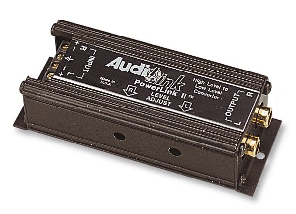

You can just get an amp that accepts High Level Inputs, and tap into the rear speaker wires in the trunk for the source...
Or you can get a High Level Convertor, in which you tap into the speaker wires, and it converts that signal into an RCA Signal...
http://www.crutchfield.com/cgi-bin/S...photos&a=0&s=0
