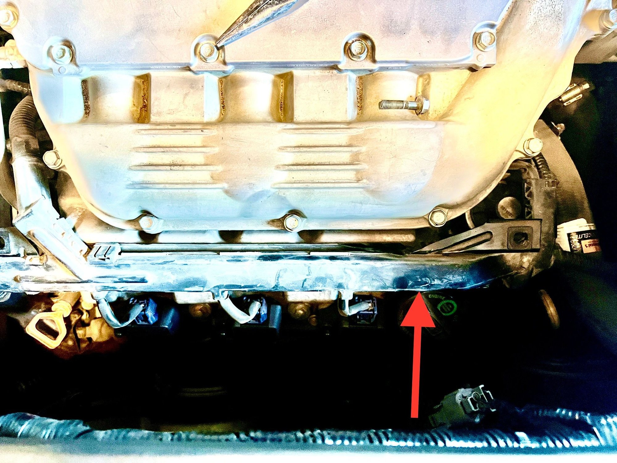

Does anyone here have knowledge of removing the harness that restricts access to the pvc?
Wiring Harness

Carefully disconnect the coil connectors, the latches on the plastic cover are bent, the wiring harness rises and retracts to the side with the help of a bungee cort.

I'll attempt to follow the instructions.
