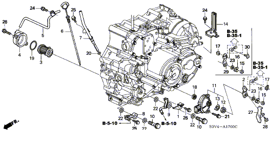

So I found the attached drawing on the forum and the part numbers I need are for items 8, 9, 10 and 22. Can anybody tell me what these are?

#8 & #9 are the transmission cooler line fittings, #10 are the banjo bolts & #22 are the banjo bolt washers that attach them.
A big concern is your radiator- if the transmission cooler lines have developed pin holes in them, the transmission fluid cooler section in the lower radiator could be next, which will allow engine coolant to mix with your transmission fluid which will kill your transmission. This is kind of a common, known issue on these vehicles.
You can get a new radiator or install a aftermarket transmission fluid cooler & by-pass the one in the lower radiator.

The drawing you posted is an Acura exploded parts diagram from an Acura parts site. The part numbers associated with the ID numbers will be on the complete diagram Go to www.acuraoemparts.com and select the correct model, year, etc for your vehicle. That diagram should be under Transmission Case or something similar.
