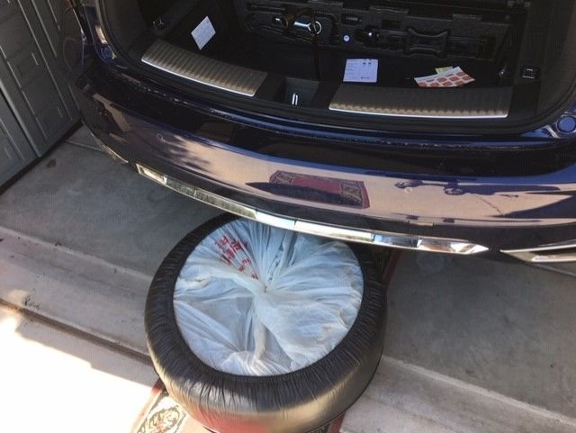

I just had the black vinyl cover for my 11 MDX at first. The inside of the tire in contact to the bottom of the MDX had a nasty dirty ring half way around the tire that was uncovered. The rim surface still got dirty and the inside bottom of the vinyl cover was full of dust/dirt. Zero issues once I added the bag (had an extra Discount Tire bag). The only issue I can think of is if you have an aftermarket hitch on your MDX? The factory OEM hitch is wide enough for a full size spare. Many 2nd Gen MDX owner's had a problem adding a full size spare with aftermarket hitches that are too narrow for a full size spare.
Here is a better pic of my 19 MDX with a full size spare wrapped in the tire bag the exact same way as my 11 MDX. I tucked the extra bag material inside the center cap. I rotate the valve stem to the rear of the MDX and rip a small hole in the bag to check the PSI.
Tire Bag:
Amazon Amazon
Vinyl Tire cover:
Amazon Amazon
