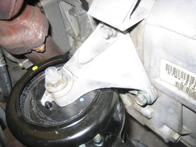

here is a pic of the top of the mount, you can see the gap between the mount and the bracket that bolts to the top of it.

Hi! that looks like a bump stop to me, for when the Engine Mount is broken the engine cannot move beyond that point.

Nevermind a picture hahah my iPhone doesn´t fit with the Fans Installed.
But I squeezed my fingers in there and yes there was the gap you pictured and I can assure you that is a Bump Stop for when the Mount Fails or when you WOT it.

Anyways, there are no codes, no leaks and as far as wheel bearing or unbalanced tires were good there to. It's mainly when in gear sitting still. If you power brake it you can feel a thud. When I looked under the hood it is the front mount hitting the bump stop. It did this with the old mount and the new one so I can't see it being bad. The right mount looks good. As far as the rear I'm gonna have to check it again tonight when my wife gets home with it. Thanks again for all the help.
