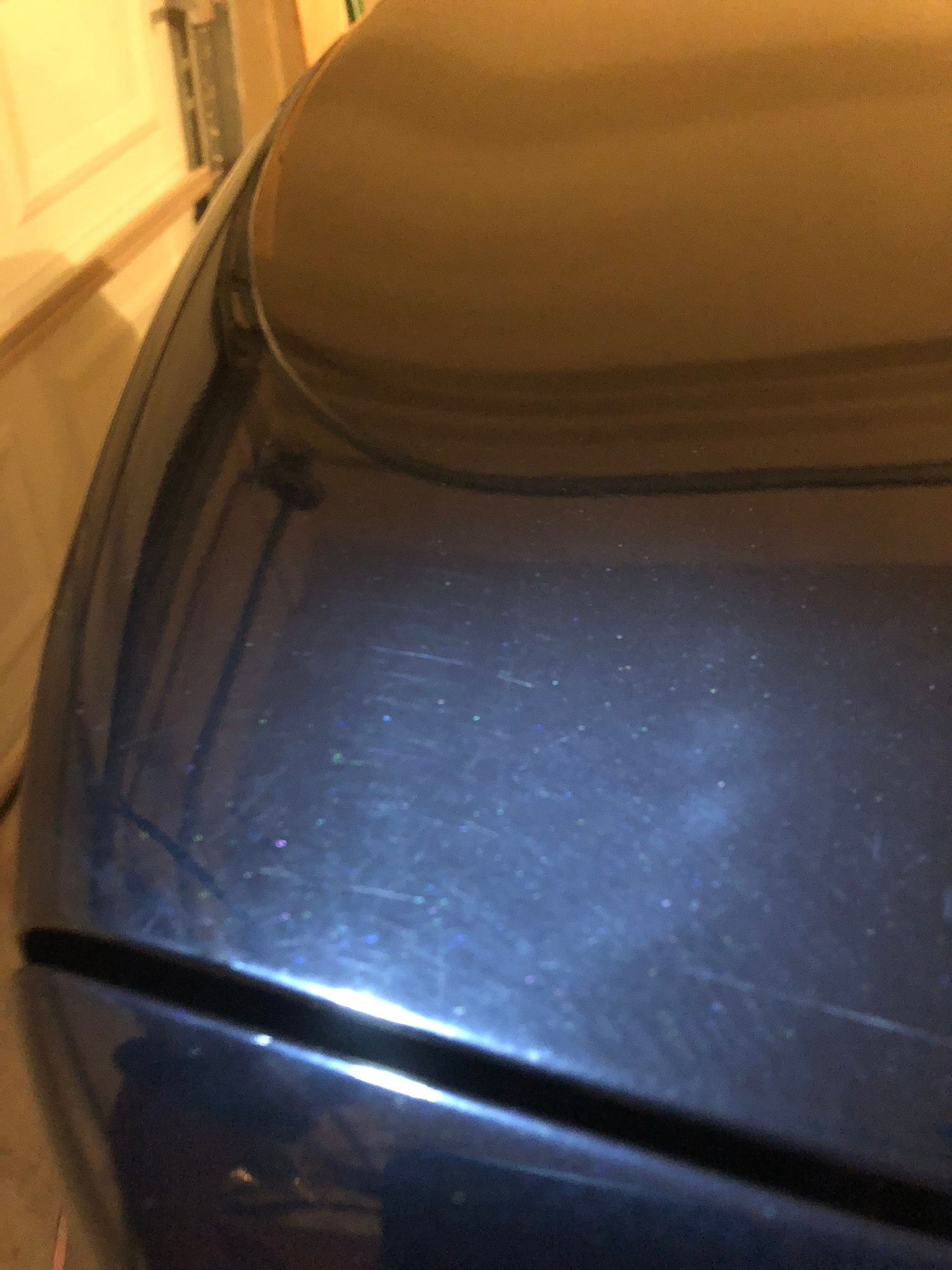

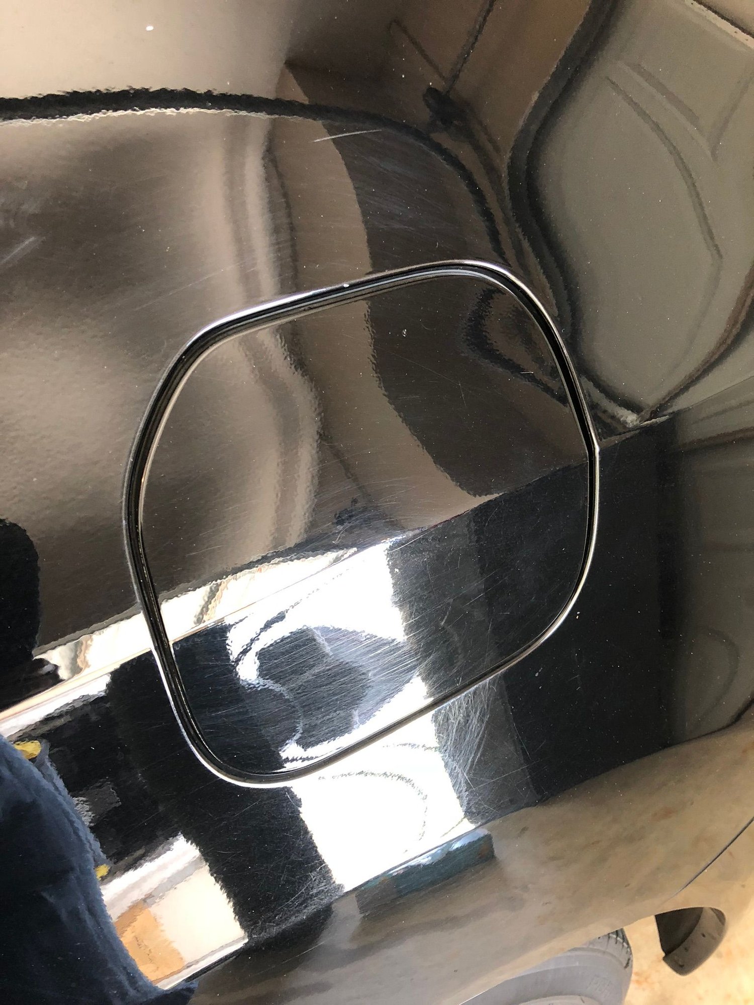

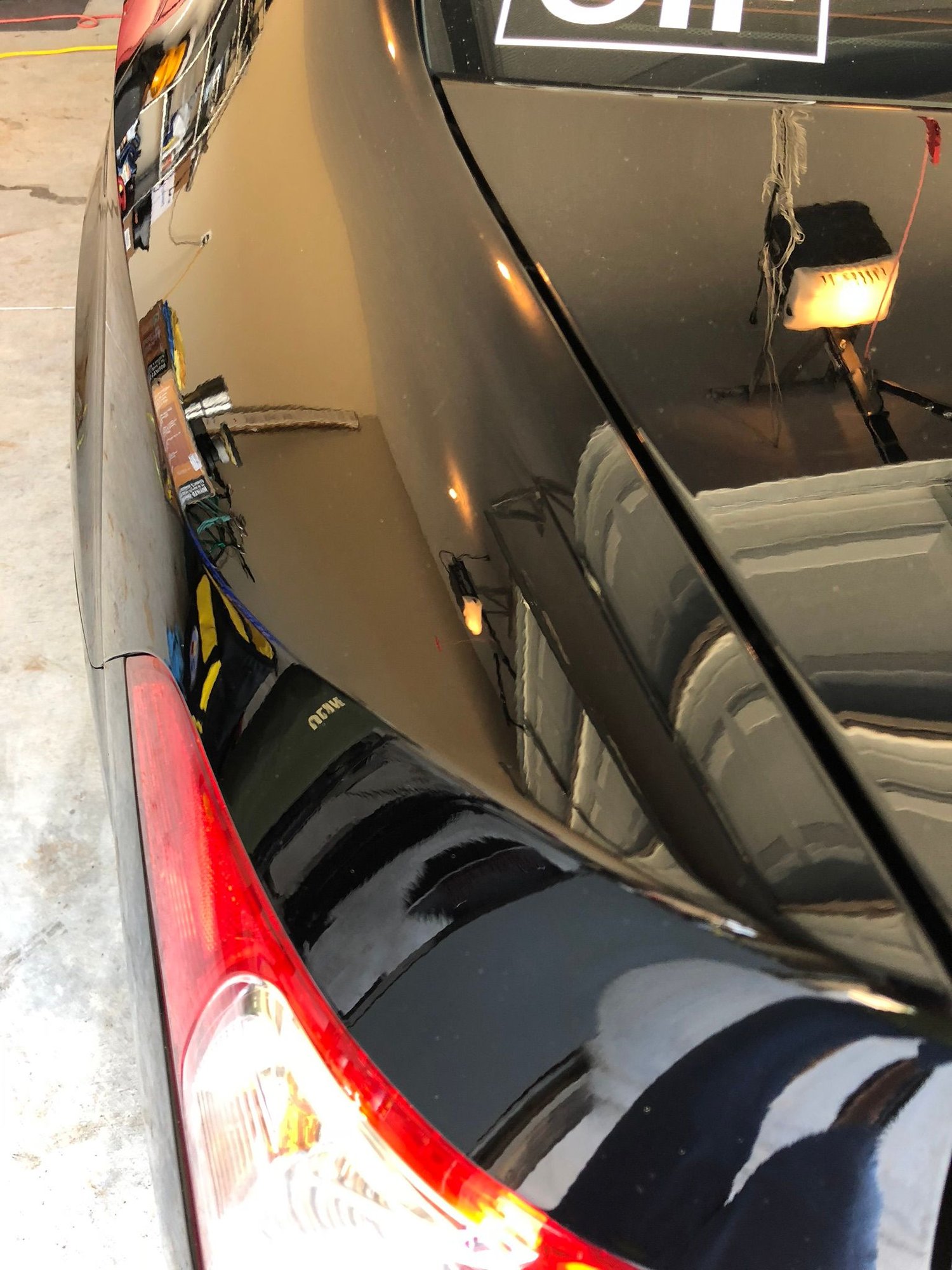

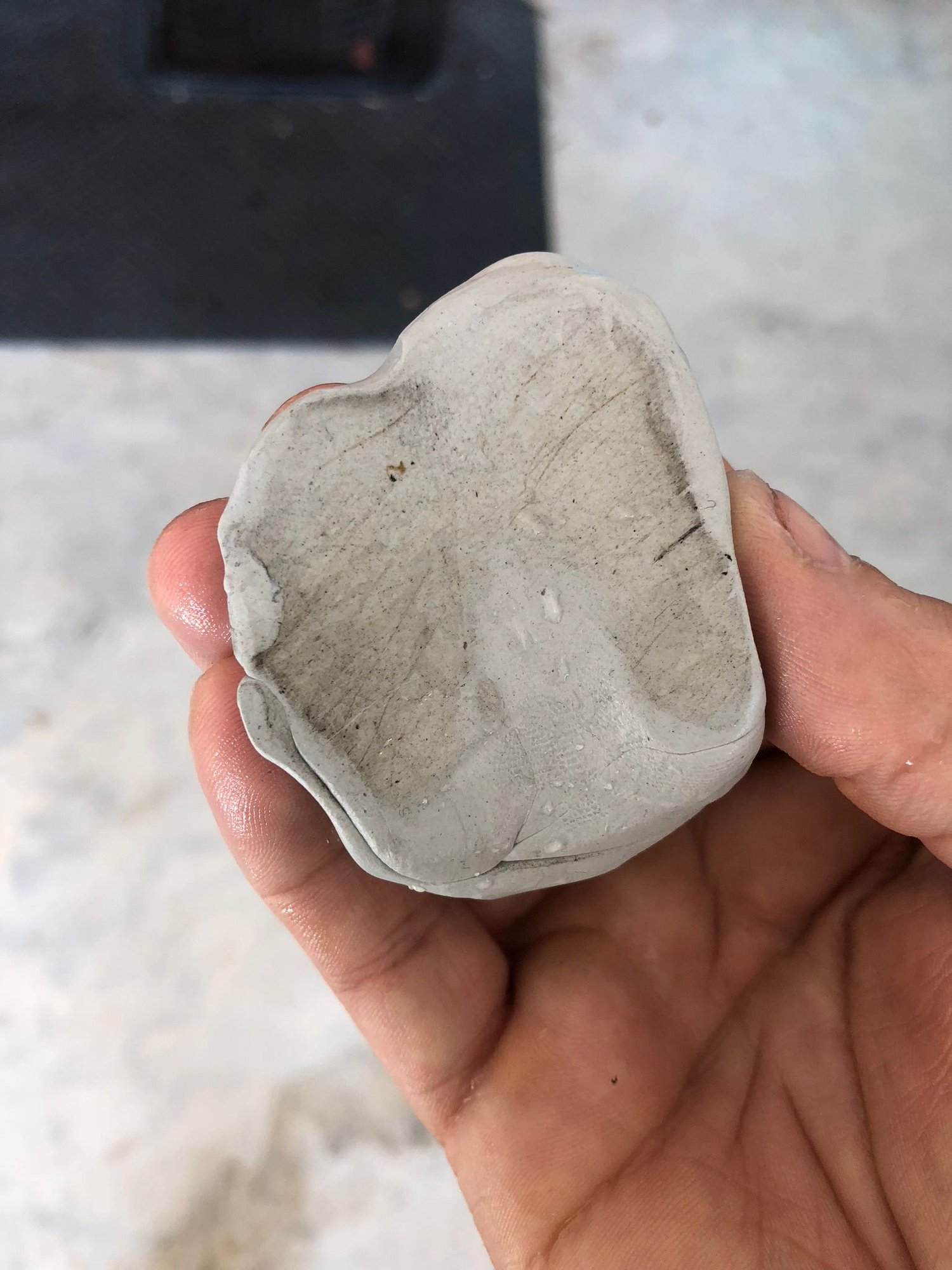

Prior to even starting on the vehicle, did a wash to remove dirt and debris. Below are pics after the ​​​​​​ clay bar to show the damage.

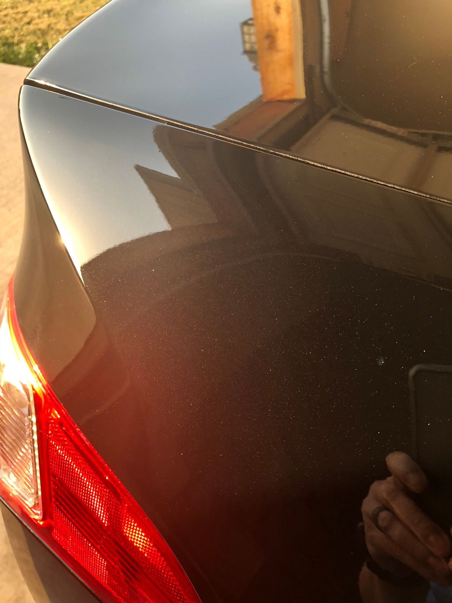

The clay wasn't as dirty as I expected it to turn out. I honestly should of taken more pictures, but I didn't. The first pic shows the top of the trunk, and the whole trunk looked this way. Below is a picture of how the trunk turned out.

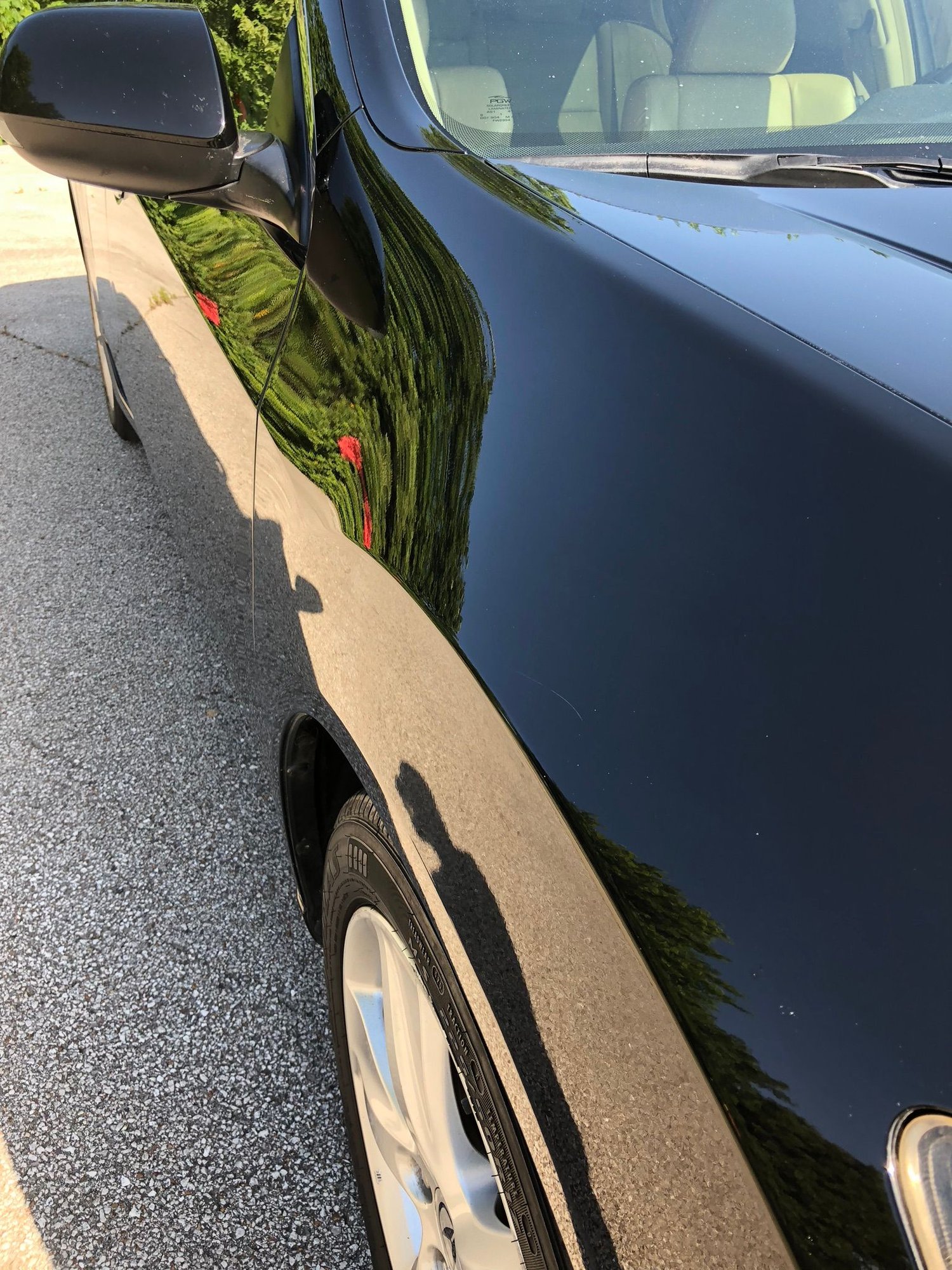

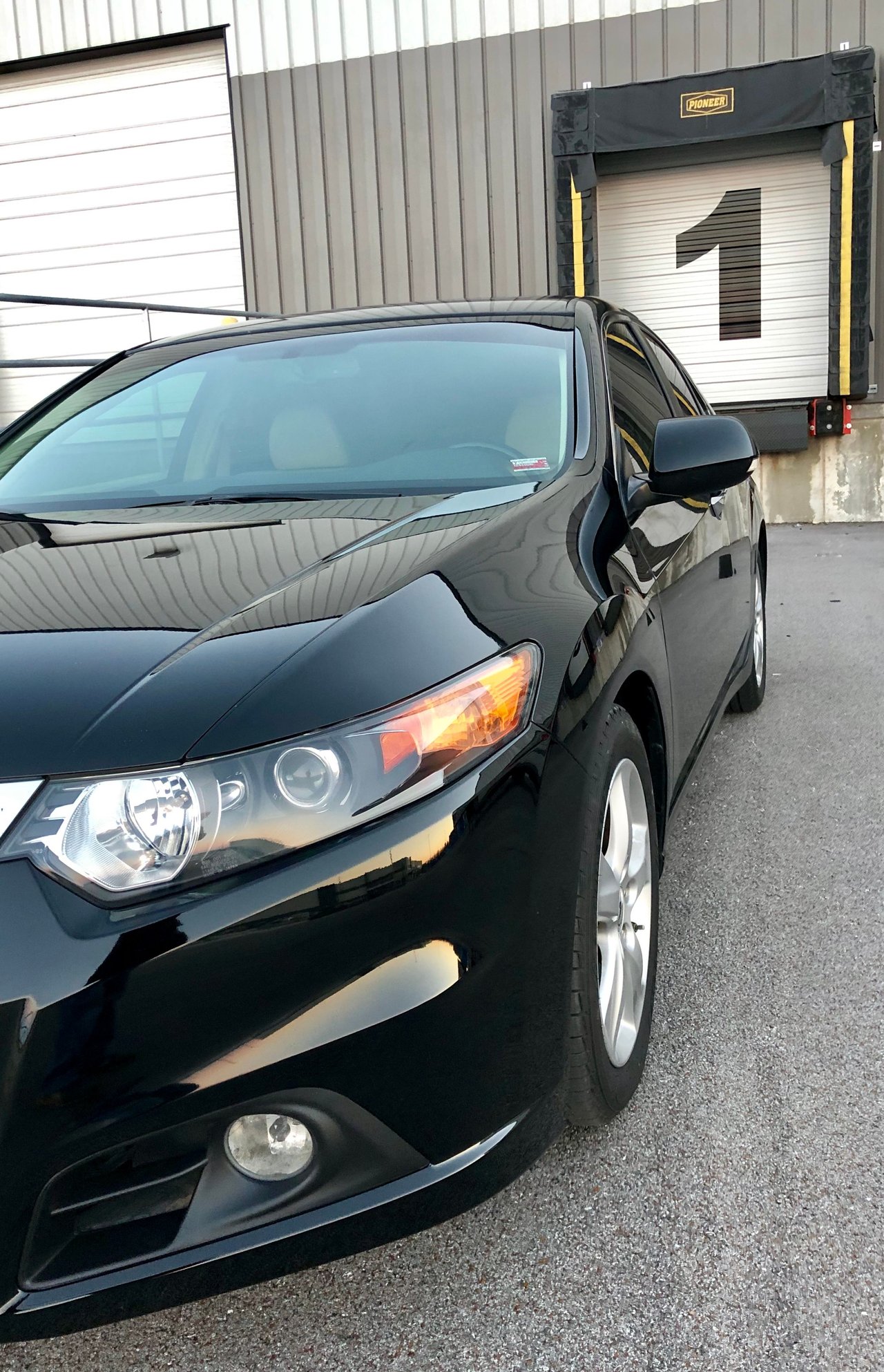

Here we see a untaped 50/50 of the drivers door.

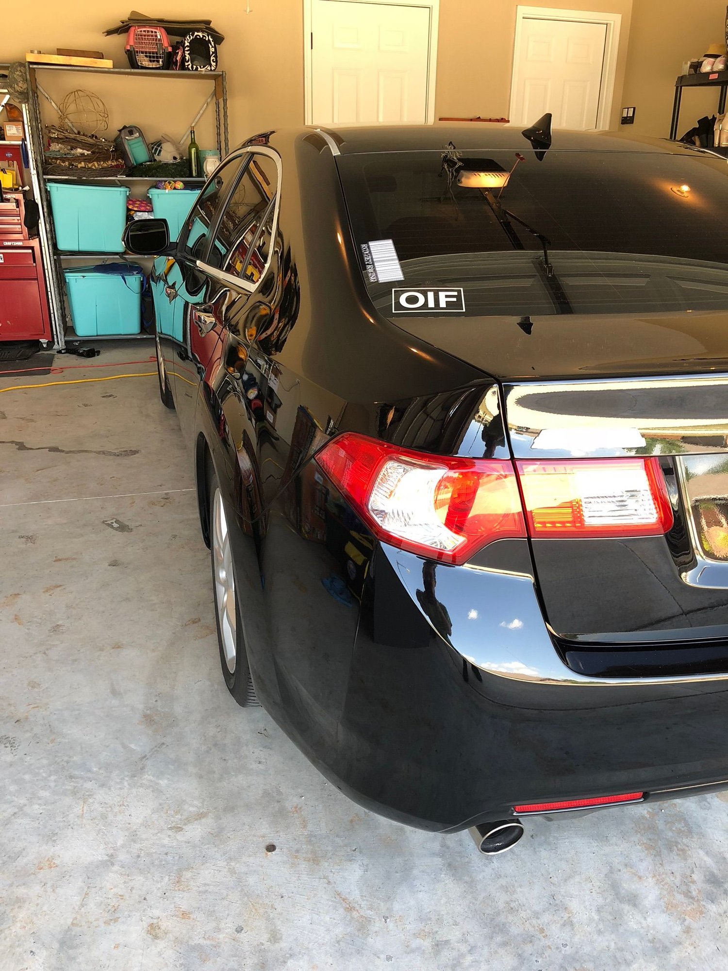

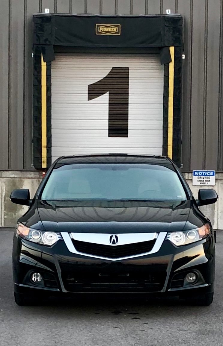

I went ahead and completed the rest of the vehicle. Honestly at this point I was super excited, for wax application. Which I used some Mother's Liquid Wax (horrible choice after the fact). Below is the finished product.
With all this being said, I completed this last June. Here in the next couple weeks, I will be doing a more aggressive correction with Meg's M105/205, as well as CarPro UK 3.0 Ceramic Coating to protect the paint.

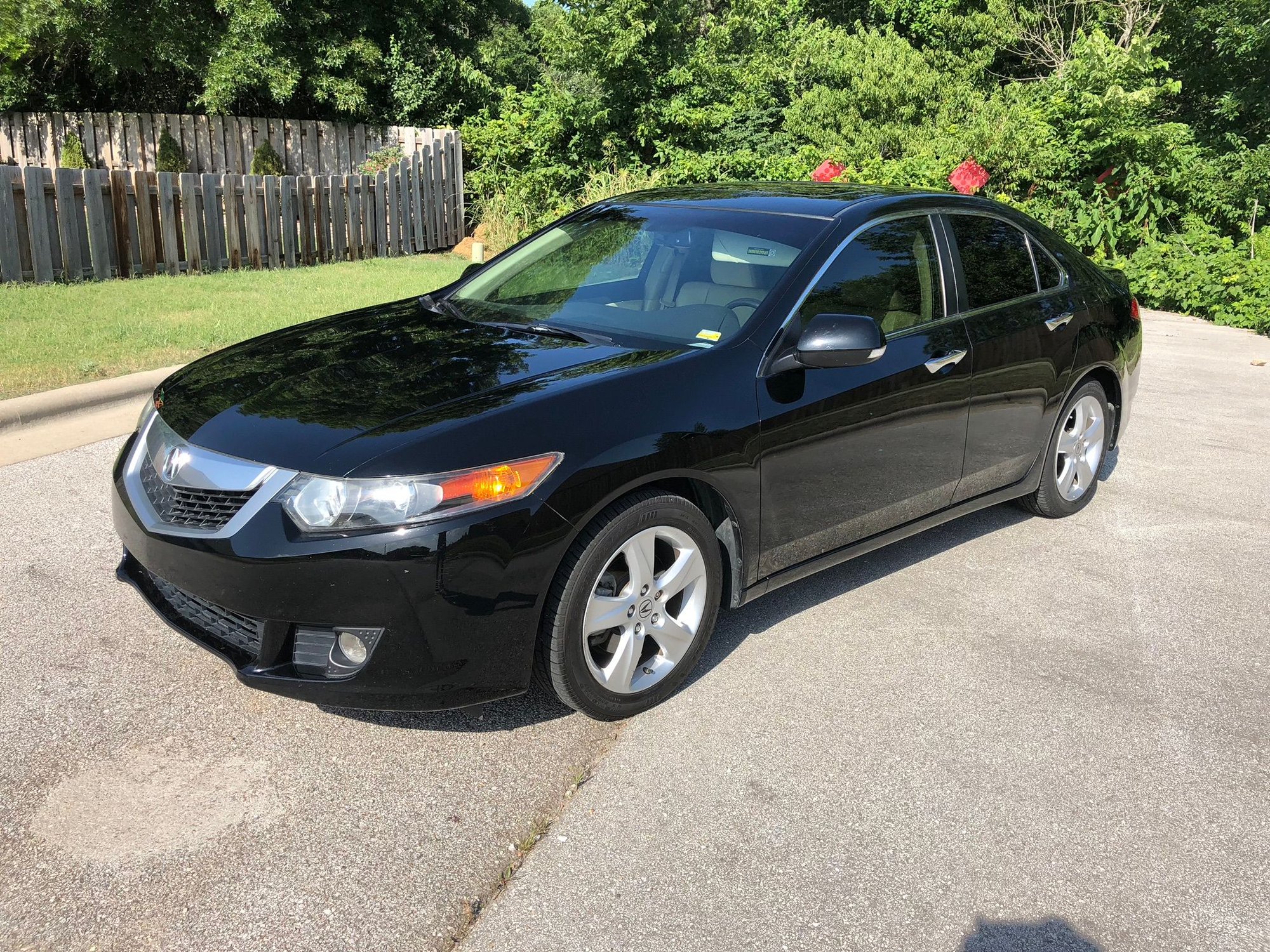

Another main reason for the 2nd correction is shortly after this was completed, I got hit in a hotel parking lot and had the front bumper replaced for the Sport (Modulo) bumper. Which I've thrown in a pic of how the car looks now. Still shiny, but winter was not kind to my car. The Mothers wax was a terrible choice, and I'm ready for a ceramic coating to keep that luster/shine all year round.
