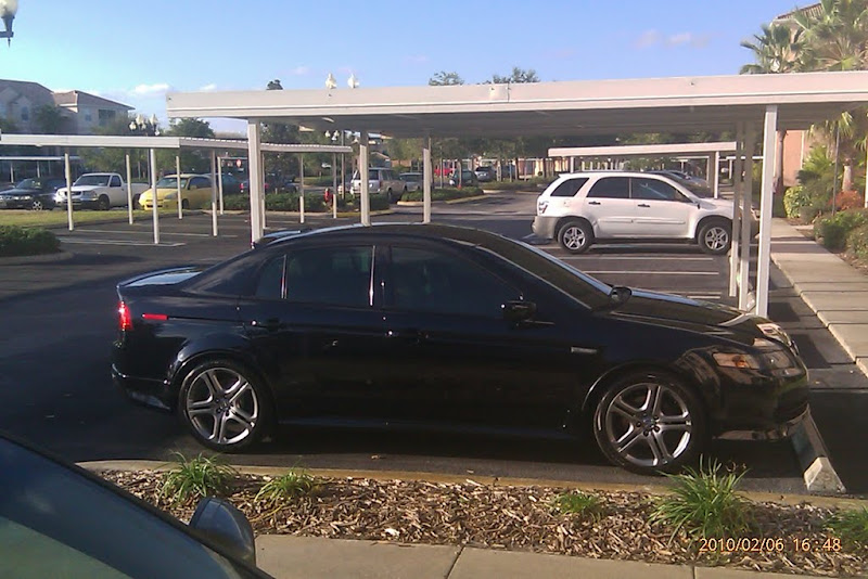

Ok...so I'm getting BETTER! Under the scrutiny of the lights I didn't see much of a difference...but seeing the pics now I realize that I made a BIG impact here!
I was polishing my emblem area as I was going to install this new amp'd emblem.
BEFORE
AFTER
And here is a comparison of my car on the right to a stock one that hasn't been loved in a while parked next to it.

and here's an overall pic of my car next to a bone stock one that hasn't been cared for as much.
