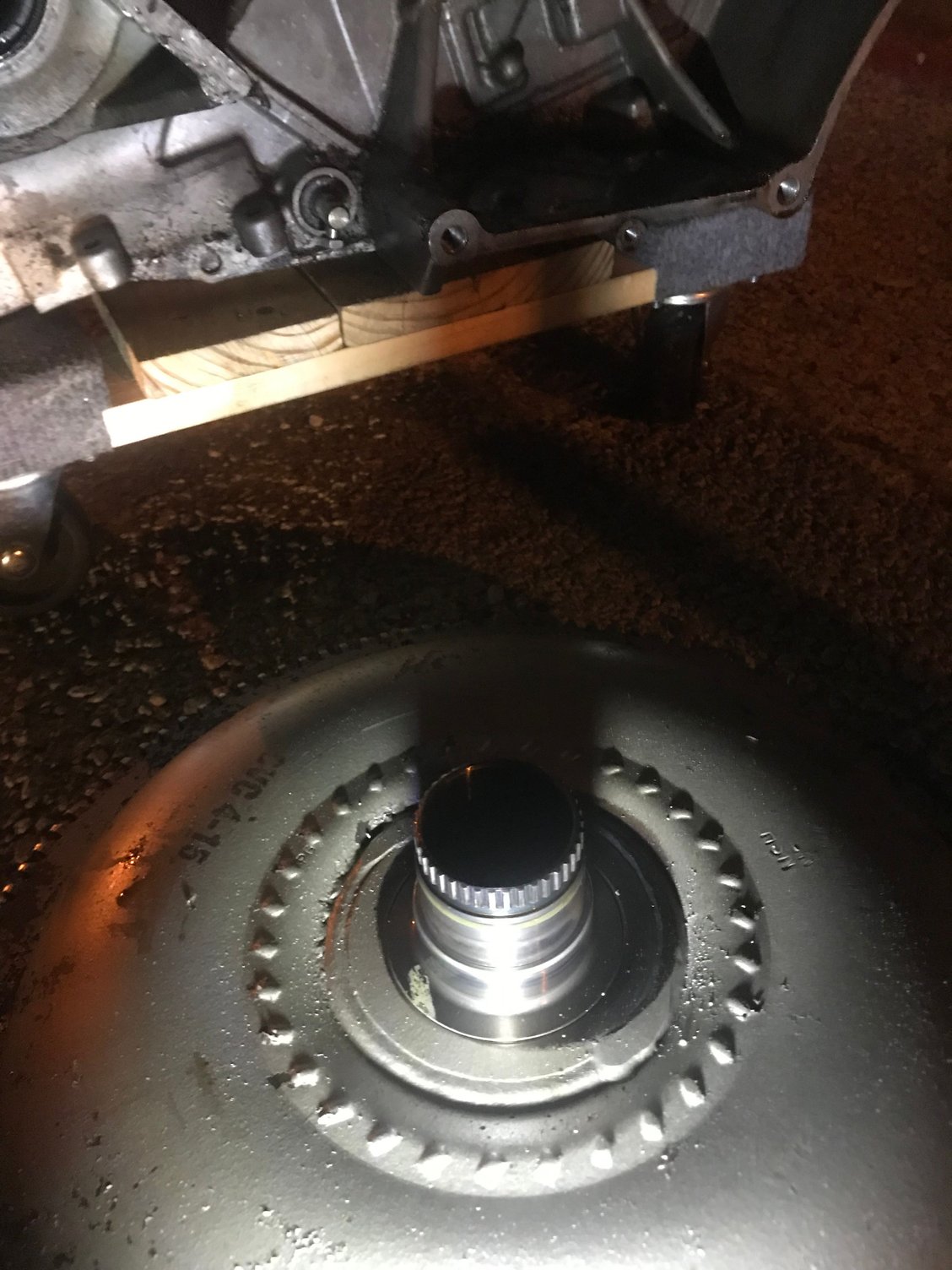

Metal shim on 06 TL tc shaft?
O6 TL tc
Shim from 06 TL tc
06 TL tc
07 Accord BAYA tc doesn’t have this shim.
Another shot of the 07 Accord BAYA tc.
Yes, the 2006-2007 AV6 transmission will fit 3G TLs years 2004-2006.
So after pulling the trans from my 2006 TL, I pulled the TC off to see if the input shaft seal had been leaking. What I found on the 06 TL tc is what looks like metal shim. Do I transfer that to the AV6 BAYA tc? I personally removed removed the trans from the 07 Accord and I am fairly certain the BAYA did not have this shim. I’d appreciate it if any you have info on this. Thank you in advance fine people of Acurazine!

Taco tom did it work without the shim ?
Im at the same spot same dilema have one with shim (tltrans) one with no shim accord trans
Originally Posted by TacoTom1967
O6 TL tc
Shim from 06 TL tc
06 TL tc
