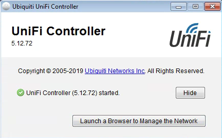

stogie1020 Jun 11, 2020 11:58 AM
I have the controller installed and used it to configure the AP last night (SSID, etc.):
https://cimg1.ibsrv.net/gimg/acurazi...26c7a50212.png
Last night when I clicked the "Launch a Browser..." my browser opened and I could manage the AP.
This morning, I get the above error (see two posts up) from my browser when I click the button.
thoiboi Jun 11, 2020 12:20 PM
restart the service.. that error message is telling you the service isn't running properly.
Also make sure Windows firewall rules is set to allow Unifi Controller to be running on that port.
also, have you tried turning it off and on again :poke: the quintessential IT fix :chuckle:

stogie1020 Jun 11, 2020 01:40 PM
I dont see any running or stopped services related to Ubiquiti. Do you happen to know the name of the service?
I did a reboot (I assume) by removing the Cat6 (POE) from the AP and re-plugging it in.
thoiboi Jun 11, 2020 01:55 PM
Sorry, i meant rebooting your Controller, not the AP.

stogie1020 Jun 11, 2020 01:55 PM
found it, mongod.exe

stogie1020 Jun 11, 2020 02:15 PM
I really need to reboot the machine this is running on but I am working on this remotely and don't want to kill the apparently-working wifi for my wife who is home right now. I will take a look tonight. If I kill java process, it fully shuts down the UniFi app.
Thoiboi, two questions:
1. is my AP configuration stored within the UniFi App or on the device itself? (i.e. if I uninstall the unifi app and then re-install it, will I lose my SSIDs, etc.)?
2. does the UniFi app need to be running all the time (either as a service or an app) for the AP to function, or do I only need to run it to make changes to the AP?
Thanks for all this help, I will put your furniture back where I found it.
thoiboi Jun 11, 2020 02:32 PM
1. AP Config is stored on the device itself, unfortunately an annoying nuance is if you set up a 'new' controller, you'll have to reset the AP to "adopt"[Unifi lingo] the AP to the new controller.
2. Unifi app only needs to be running to make changes and to look at those sweet sweet charts while running, it has no bearing on the AP working. As I alluded to earlier, there's an AP "standalone mode" you can set up by connecting from the app straight to the AP and have it working sans Controller. But you seem to be the type that would like to be able to manage AP's from afar, thus my suggestion for Unifi Controller :shrug:

stogie1020 Jun 12, 2020 11:09 AM
:rofl:
I rebooted the W7 machine and everything seems to be working fine.
