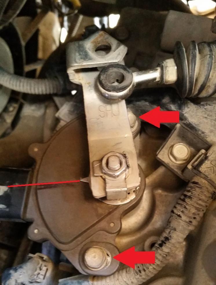

The shifter unit is mainly a physical connection between the trans park fork and the gear lever... The only electronic "Shifting" the lever does is in while Sport Shift since it uses a pair of rocker switches to tell the ECU to shift the trans manually and when selecting 1st Gear manually. Otherwise the lever only job is to pull the parking fork out and the transmission shifts into drive or reverse thanks to the Transmission Range Switch.
This is why the car cannot work without the TRS, the car will even refuse to start if the TRS is malfunctioning because the ECU cannot tell if the car is in Reverse or Drive.
If you remove the TRS out of the equation and pull the Shift Lever into drive or reverse nothing will happen (Somehow you will have to start the car in the first place which is impossible without the TRS) other than the car being in full neutral as the shift level will release the park fork and leave the transmission idling for input from the ECU, since the ECU does not get any info from the TRS nothing will happen.
This is the basic function of the TL TRS and Shift Lever:
The shift lever cable goes directly into that ARM, that arm connects to the Park Fork shaft in between its the TRS (Thing being held by the 2 bolts pointed by arrows), The TRS has a splined hole that connects into the park fork shaft, If the park fork shaft rotates the TRS will send a signal corresponding to Park > Reverse > Neutral > Drive > D4 > D3 > 2 & 1 (First is electronically controlled but lever must be set into the final slot of the Shift Gate so the TRS tells the ECU that is in that position when you move the shift lever to 1st the TRS does not move). That is the basic functionality of the Shift Lever.
That is why this mechanic is full of s****... The issues he is having is directly related to his shitty rebuild.

So this might sound too simple but; has he checked his installation/adjustment of the transmission range switch? While the gear shift controls forward and reverse gear selection the range switch tells electronics what gear it thinks the transmission it's in. The switch seems to be given given short shrift in these discussions having it even a little bit off can cause issues that run from strange to dangerous. Things like:
- Not being able to shift out of "P" without using the manual release.
- Not being able to shift from "R" to "P" without using the manual release.
- Non-working brake lights.
- Non-working transmission indicator lights.
- ABS, VSA deactivation.
- Weird codes

There are two things going on here. 1. The shop is incompetent in rebuilding your transmission. 2. The shop committed fruad against you when they charged you for a new shifting part but then fabricated the part instead of replacing it.
I believe the shop fry your Engine Control Module (ECM) because there was no Diagnostic Trouble Codes after the first trans install for 9 months. The ecm broke after the install. I believe the rigging that they did may be the root cause of the second trans failure.
Specifically, their make shift Shifter part modification probably failed or went out of adjustment just enough to send multiple and/or wrong signals to the ecm. By doing so the trans engaged and/or disenaged gears and/or multiple gears at the same or wrong time causing damage to the transmission. Likewise, multiple signals could over load an ECM and cause damage to the related integrated circuit.
I think you should just sue them for a full refund or for the price of a transmission replacement (Get estimates).
You have all the evidence you need to win. Specifically, they committed fraud when they charged you for a Shifter part and then substituted a fabricated part instead as indicated on the repair invoice.
