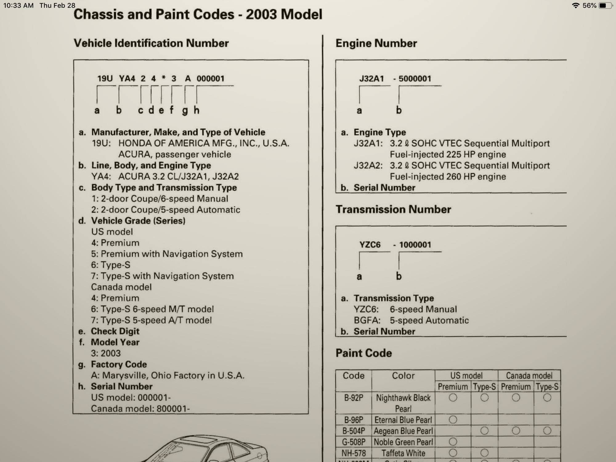

I think its starting to make sense. What manual says is correct, and probably means that factory (original) transmissions on 03 are labeled as MGFA, while factory 01,02 are labeled with BGFA
However, when transmission fails, they re-use whatever case they get. So looks like StonedCL got a case which used to be original in 03 model. Like I said before, my sticker looked old and discolored, something indicative of time. It certainly looks like an original sticker that was put on a case when the case was manufactured. Probably all modifications for 2005 are really inside, and cases are identical.
MGFA was used in 2001 and BGFA was used in 2002 and 2003 I got this from the 2061 page Acura CL service manual.

A ten year thread bump? Why?
The truth is, this information is so very much out of date as the BAYA transmission from the 2006-2007 V6 Accord is the go to transmission for the 2G CL.

Yeah that’s true the BAYA AV6 swap is best but its mainly for anyone who wants to know the info if they are going back and reading.
