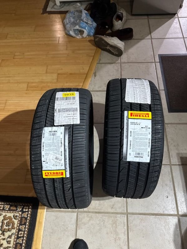

Hey guys, new to this community so might not be soo knowledgeable with all the terms or spects but,
I have 2017 Acura ILX tech with stock 17 inch rims and was looking to get 18s with 245/35 all-season tires.
I am looking to get the Enkei Performance Phantom (link below the picture) in 18x8, 40mm offset, 5-114 bolt pattern. I wanted to go with 245/35 tires for the wider look and was wondering would I have any issues in terms of rubbing or anything like that.

This is 245 35 18 on 18x8 45 offset Enkei TS9's at stock height, no spacers.

Have you had any issues in terms of handling or any rubbing. I asked one of the tire/wheel shops and they said 245/35s were pushing (in terms of rubbing). That's why I'm asking around here

No rubbing with the 45 offset, but I've never driven with 5 adults in it.

Here's a pic of a stirring stick against the sidewall for better visual of "will it fit?".
