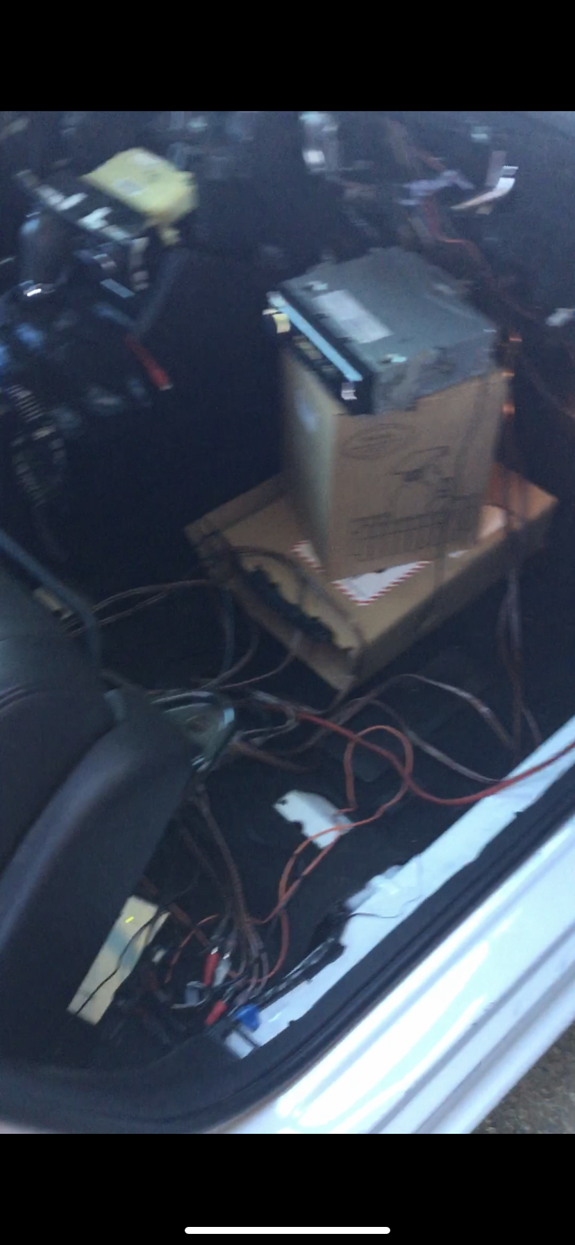

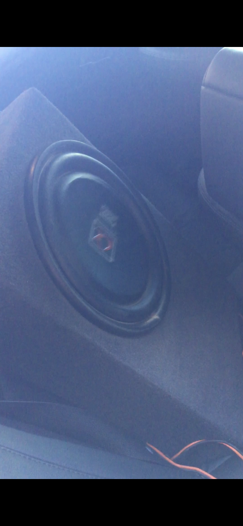

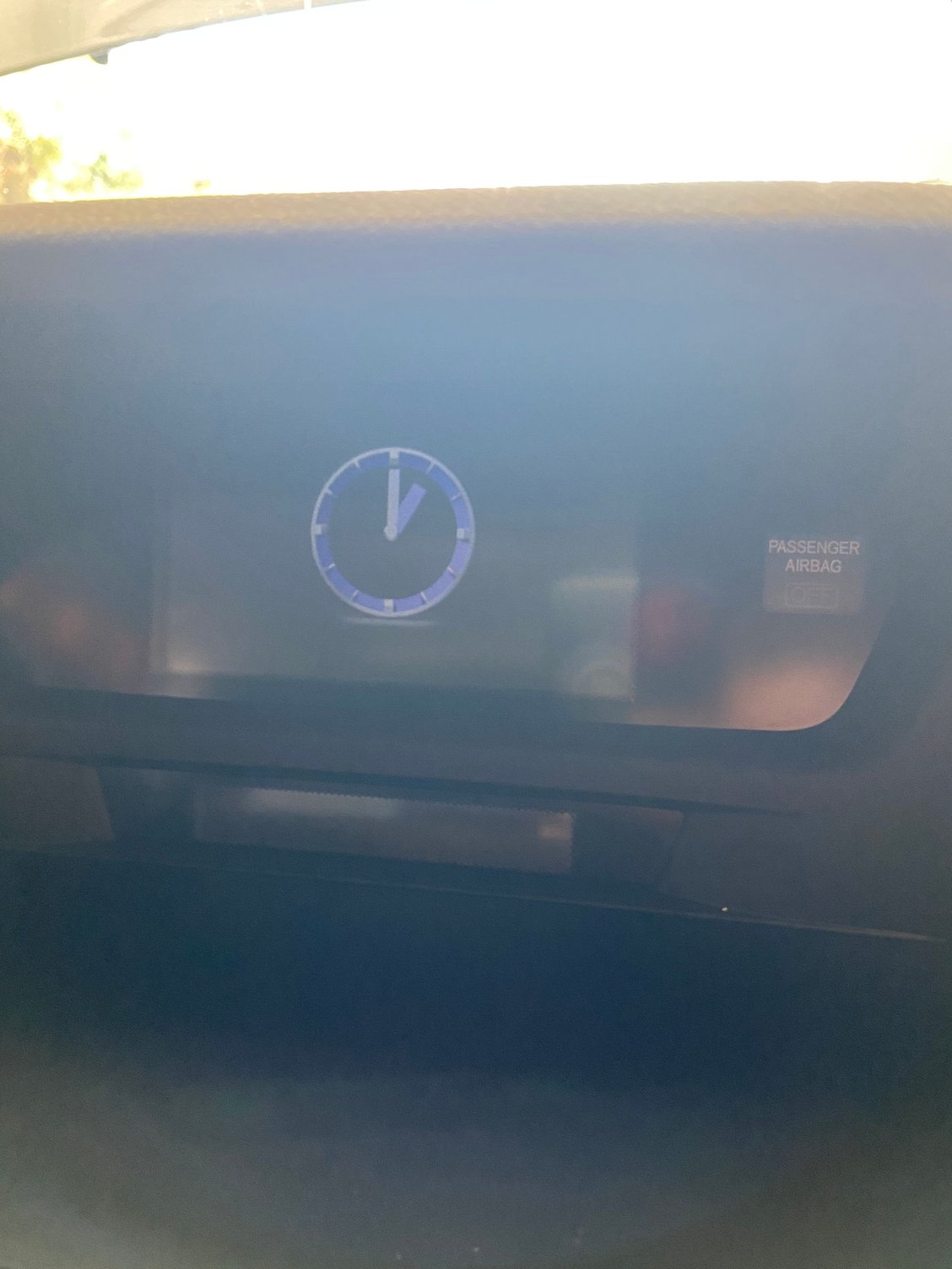

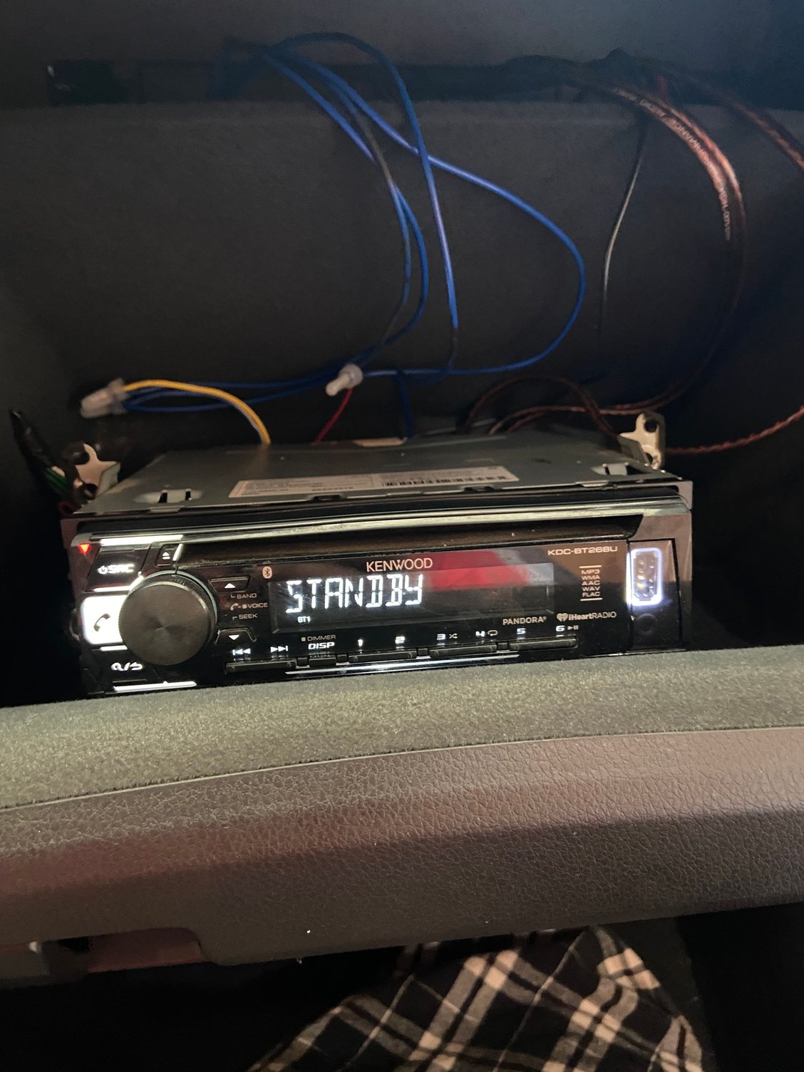

Recently added aftermarket sound system, on my own, after much research. I was a little intimidated because my system was originally installed by a shop in my two previous vehicles. I have the 2017 ILX Base model. I was able to keep my OEM radio in tacked and harnessed my aftermarket receiver, amp, speakers, and sub. The aftermarket receiver (head unit) is in the glove box. After everything was installed I realized I no longer had my reverse cam. So I got an OEM harness and supplied power to OEM receiver (red, black, and yellow) wires and it worked out great. I also got my clock back. Easy to do, and I think researching first is what got me all nervous. The best link I found on here was for crutchfield. I got the door panel tear down sheet for $10. Well worth it. 3 hidden screws I never would have thought about were in all 4 doors.

Volume controlled by phone, Apple Music. Virtually hands free, glove box stays closed with wire clearance. Additional bass volume control drivers side.
Regained screen power. Backup cam/Clock wallpaper.
In-progress pic
