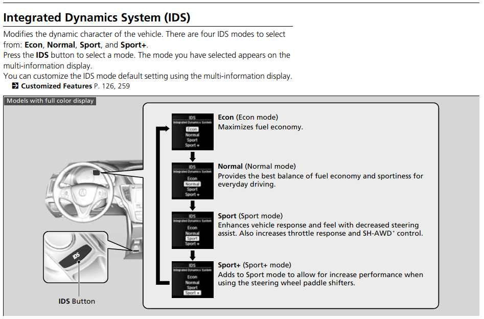

At 73 MPH my RPM stay constant no matter if I am in Econ, Normal, or Sport. If I switch to Sport +, then the transmission automatically downshifts and that raises the RPM. At 73 MPH you're in top gear plus overdrive regardless of what mode you are in, except for Sport +.
I think people think IDS does more than it actually does. Acura sure makes it sound like a powerful tool by calling it "Integrated Dynamics System," but IDS really only changes throttle mapping for fuel economy. My guess is it feathers the throttle in ECO to accelerate gradually. Sport+ forces the transmission to hold gears longer and avoid the top two gears. Acura claims Sport lessens the steering assist, which I take to mean some power steering feedback adjustment? I've never been able to feel a perceivable difference. IDS should not be confused with any dynamic vehicle setting - engine mapping, suspension spring tightness/shocks pressure, transmission shifting, etc. I think IDS is smoke and mirror advertising more than a driving tool. The only thing that would have legitimately changed what you're describing would be Acura ECU/TCM update/remapping/reflash and idle relearn cycle. That actually changes the car's computer system software.
^--This here too. At 73mph, I'm in 9th gear running between 1500-1600rpm. When I cycle through IDSs while cruising, the only mode that changes anything is Sport+... The only thing that would have legitimately changed what you're describing would be Acura ECU/TCM update/remapping/reflash and idle relearn cycle. That actually changes the car's computer system software.

Regarding IDS modes: I'm glad to report that a great friend of mine confirmed to me today that he has perform many road tests and his TLX currently behave like mine used to behave (see my hereabove post for a behaviour description). Accordingly, the RPM of his 2016 V6 TLX "fluctuates a lot from one IDS mode to another" (Note: we both are located in Canada, although it should have nothing to do with it).
I believe the firsts three (3) IDS modes (Econ, Normal and Sport) on my 2015 TLX were disactivated and merged (or disabled) sometime during 2018, probably in Fall. I believe this modification may have also been applied to other cars, since Carl and "Momyc" reported their TLX acts like mine does now. Could this have been possibly done by Honda in order to disengage the "self-learning" of the ZF9 Transmission as well as to "move" to a slower speed (ie: 115kms(63mph)) the vibrations originally reported at 117kms/h (73mph)?
I would like to hear from other TLX Owners who can report their TLX IDS modes still does have a direct effect on the RPM.

^^^ in order to rectify my previous posts, and in order to not be misleading anyone
I road tested my friend's TLX today and, after verification, I have to admit his car does not react much differently than mine does with regards to IDS modes and RPM range. I was told differently, but the fact is that only the IDS Sport+ raises his RPM. Accordingly, the Econ, Normal and Sport IDS modes are not modifying his car's RPM any differently then then what it currently does it on my car. This new fact sheds a dought in my mind about my conception of how IDS modes used to react. That said, I'm also wondering why my personal video shows my TLX running at 1450 RPM, in Econ mode, at 117km/h.
I'll keep looking for answers but, at this point and until I'll find new evidence that RPM used to be reacting to Econ-Normal-Sport IDS modes differently than it does now, I'll have to suppose I might have been wrongly assuming IDS modes were reacting independently. Sorry for this confusion.
That said, today's road test confirmed both TLX are vibrating the same way when VCM engages and engine run on 3 cylinders.
