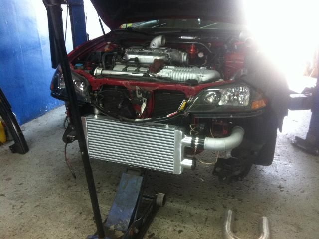

You don't need to move the throttle to run a blow off valve, just check out this CL he is running a front mount intercooler & BLOV...
Here is a link to the rest of his build...

Yeah I saw this car too but he change the bottom of SC going straight down to intercooler but our SC going up to manifold...but thanks man for the pic... I will figure out later.
http://www.tunerzine.com/view_articl...y-wide#gallery
His FMIC was all show; no piping on either end... smh
Not to mention, the CT Ice Box was installed
