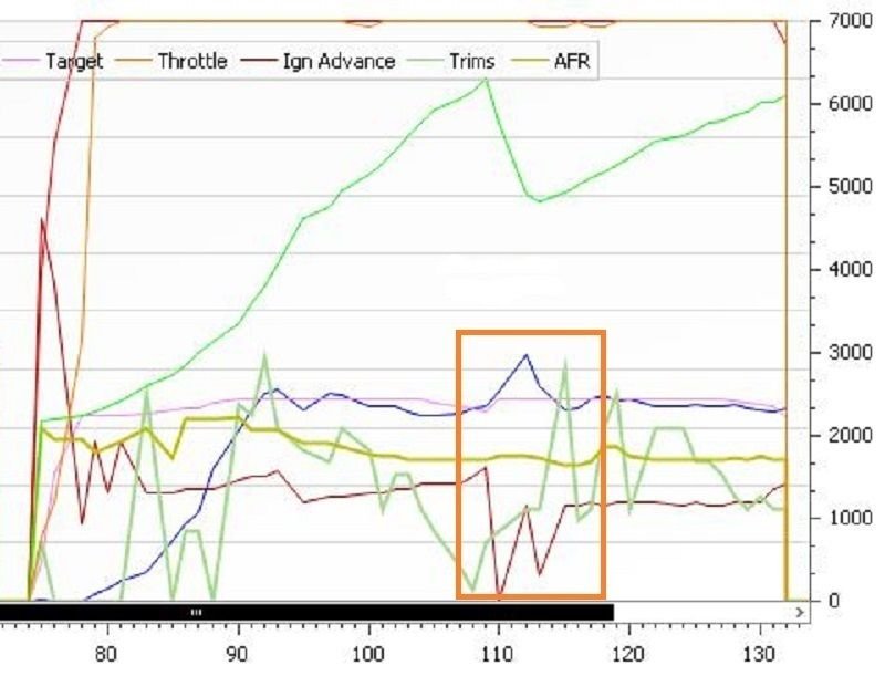

There is no logical reason to increase throttle lag off idle from a standing start. If there were it would be common place. My non turbo cars are all instantaneous. The turbos don't feel instantaneous in some cases because the turbo needs to spool up. That said most performance cars have launch control apps to spool up the turbo before the brake is released.
If you feel a lag over the road when you mash the gas blame the transmission not the throttle. Yes they will shut down the power at red line etc but its not the throttle getting cut its the ignition & timing.
Follow the vertical yellow line next to the red (Pedal Position) one far left. Yellow is the TV position. Top of the chart is WOT. Hit a major shortfall on octane due to excessive turbo boost around 110 & the engine had to pull in its horns to prevent detonation (knock). Show me where the throttle valve was reduced from WOT during the event. All management of the issue by the ECU was through timing & fuel adjustments. Throttle stayed at WOT the whole time till I released the pedal.
I was rolling during JB4 beta testing when this happened & the result of the pull back had I not been well belted in would have been a face plant onto the steering wheel.
