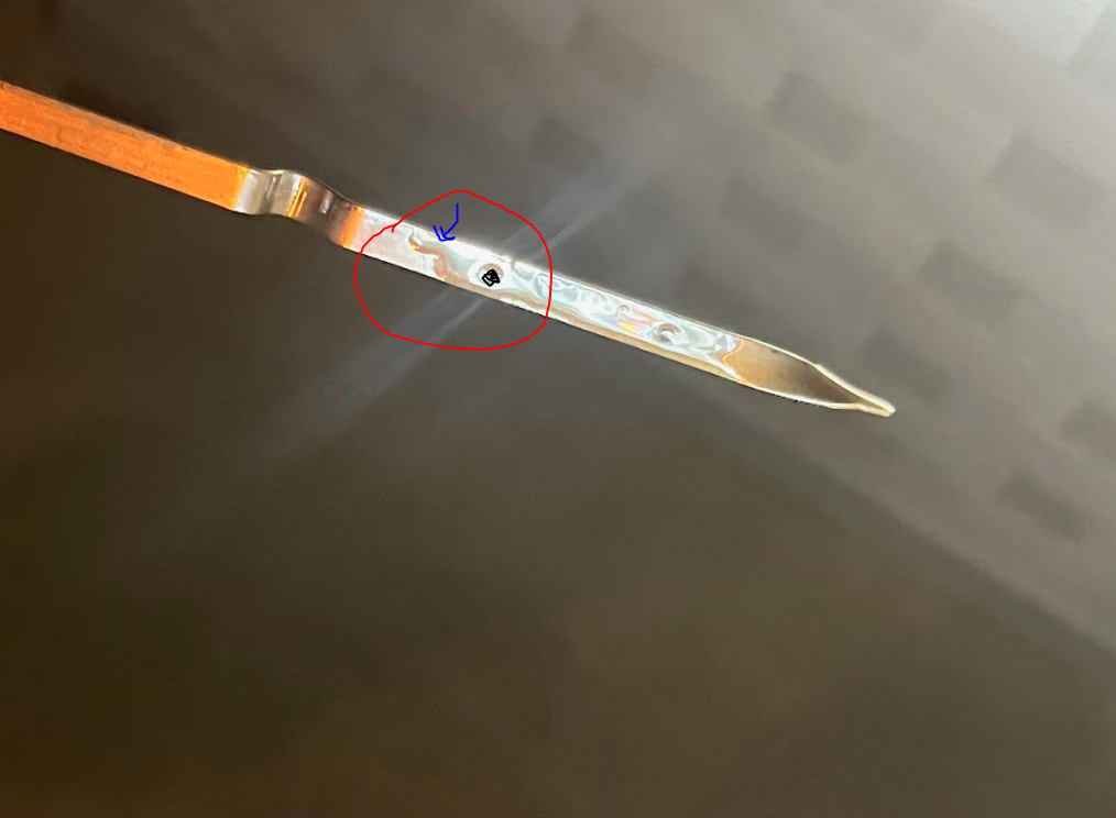

Used 0W20 synthetic and filled between the 2 dots on dipstick? Used the correct oil filter? Your video doesn't appear to show valve cover gasket leaking onto the serpentine belt tensioner causing a noise.
This is an image from a cold-engine.

Level should be between the 2 holes on the dipstick - check after three minutes after shutoff. I have same engine and don't have that noise. Check pulleys associated with serpentine belt, alternator, water pump and tensioner.
