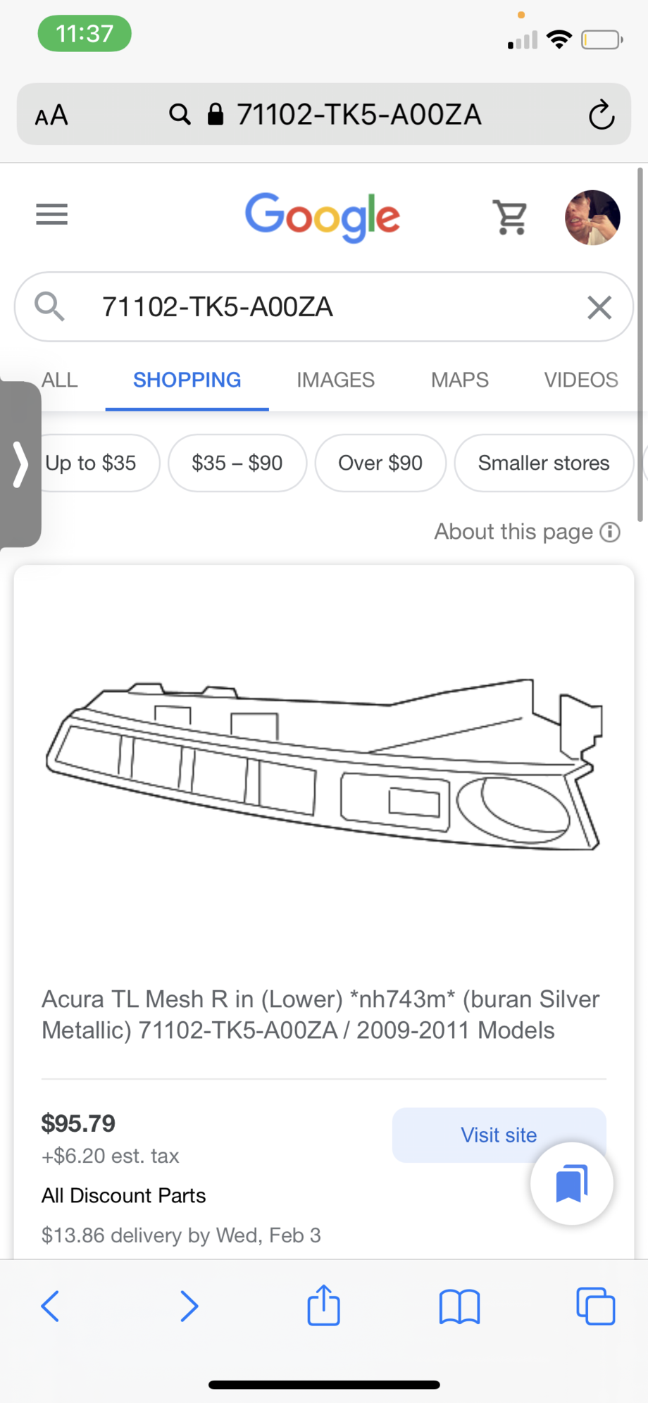

Ik this thread is REALLY old but I am now trying to do this swap and I can only find part that looks like it’s missing a top piece. Almost as if you have to buy 3 separate pieces now instead of 2. Idk the help would be greatly appreciated.
