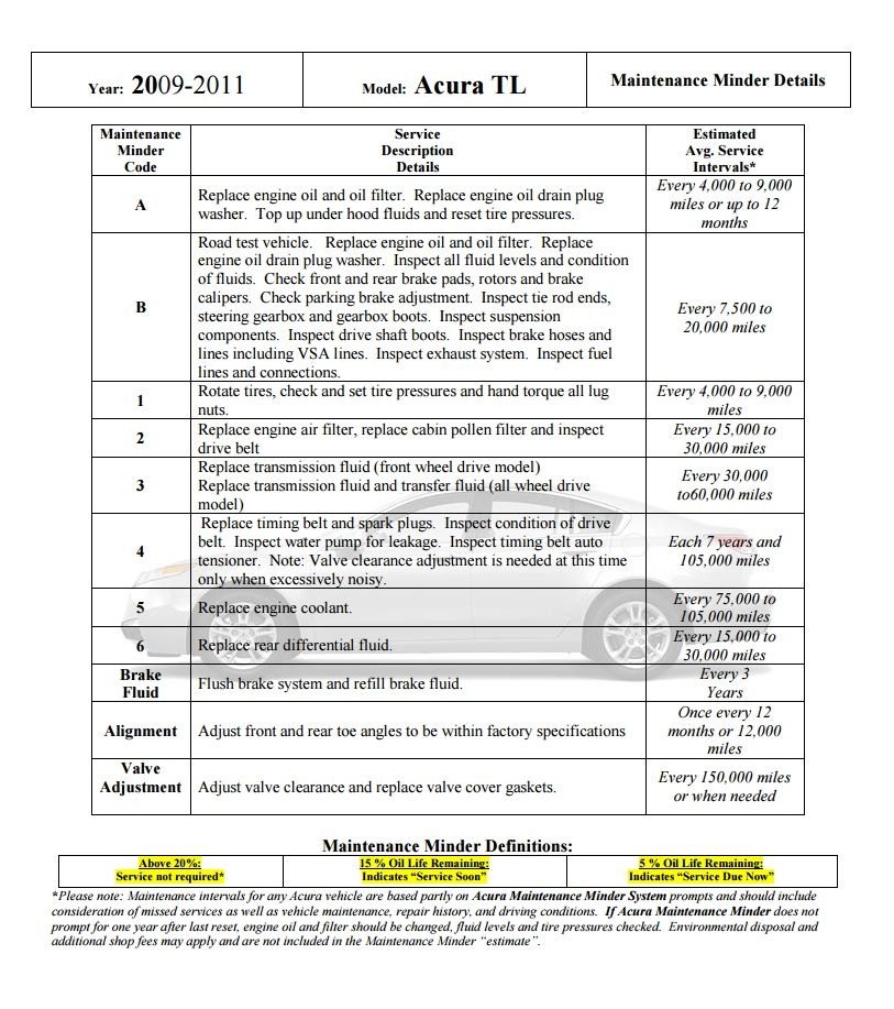

Hey yall,
I bought my TL a few years back in May of 2019 and I was wondering what major maintenance items I should consider doing.
Bought the car with 92k miles and I have 137k now, Timing belt was taken care of before I got the car. Hit me with your recommendations.

Old Jul 13, 2022 | 05:19 PM

Originally Posted by altair47
Well shit, would ya look at that.
This is good to have, I appreciate the info.

Other than the obvious ones that you can inspect visually - if you haven't done so already, I would do 3x transmission fluid change. For coolant and brake fluid, I usually rely on
test strip test strip
to tell me.

first thing I would do is New spark plugs if they haven’t been done yet & go with the NGK that in all our cars that Acura recommends only using
