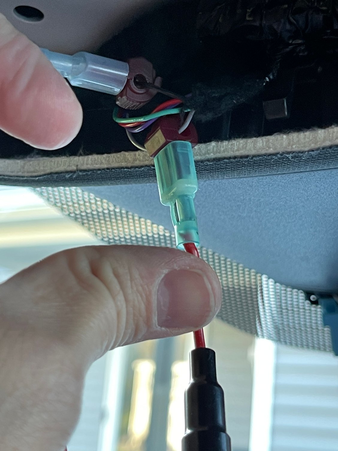

I’ve seen a few posts saying they needed to wire their radar detector or dash cam to a fuse tap. Wanted to share that there is accessory power (only on when vehicle is on) near the dome lights.
The connector going to the mirror itself which controls the photocell and homelink has the appropriate power but I tapped into it right above the dome light.
Hope this helps someone
Grey is 12v and Black is ground. This is directly at the rear view mirror.
Trace the wire above the dome lights as you will have more room for the connections.
I used T-Taps and spade connectors for mine.
I used a rounded file to have the wire come out directly from the plastic cover.

you should be able to use that style connector AKA “mirror taps”.
i used a plastic trim removal tool and pressed it against the glass and the corner of the trim (all the way at the bottom) to release the clips.

Thanks again to BrandonClaps for his photos and wiring information. The mirror tap works perfectly in the grey and black wire slots of the mirror plug harness on my 2022 MDX Aspec. The only issue was that I broke a pin probe on my old Mirror Tap that slips into the wiring harness plug. Instead of ordering a new one for $29.99, I tried a generic set from Amazon that comes with three complete longer wires using different sized pins costing only $16.95. The one with the smallest pins fit best.
Although the Blendmount website doesn't offer a mount for the Acura, the one taken from my 2016 Pilot worked fine after inserting a bushing strip that they provided for another car.

I notice that hardly any people use an extra low-ampere fuse when they tap into the overhead/mirror assembly circuitry. It is true that the factory circuitry is already properly fused. But the minimum fuse size used for Honda/Acura vehicles is 5A, when most radar detectors and car cams are rated at 1-2A max.
So having 5A of current going through a malfunctioning radar detector or car cam will sure smoke the car or, worst case scenario, start a nasty fire. Therefore, it is much safer to include a 1 or 2A (according to device specs) external fuse before splicing anything into the factory electrical system.
