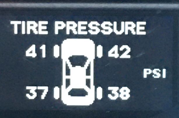

So I just got some new tires. summer firehawk indy 500. This is my first time rolling on UHP Tires. They were on a pretty good discount and I noticed the difference immediately. I see that my door jamb says 38 front 35 rear. I have attached a pic of what my tpms says. Yes this was after work and it was around 78F at the time, but I hadn't left the parking lot yet. Even first thing in the morning the readings seem a bit high. So my questions are: Did they put maybe a bit too much air in after putting tires on? Is it just this high when warm? Should I let a little air out? TIA for your assistance!

First thing in the morning check the pressure. then deflate to the proper pressure as indicated on door jamb.

Double check the pressure with a good pressure gage, make sure it reading whatever your door jam said. I believe its 33 PSI for front and 30-31 PSI for the rear.

TPMS may be off 1-2 PSI so it's always best to check with an accurate gauge before adjusting tire pressure, esp when cold!

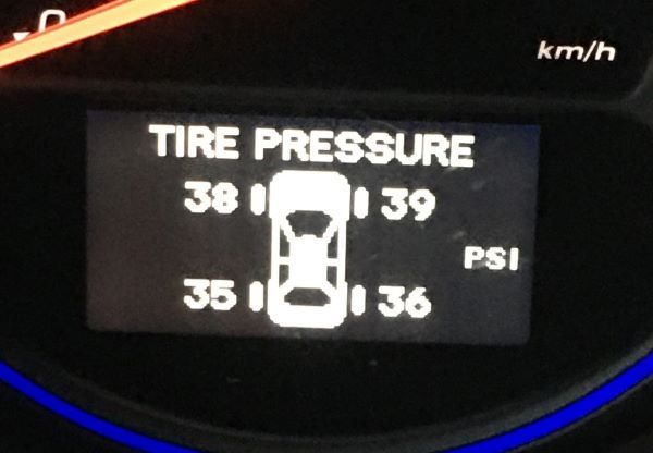

juchale's Avatar
Joined: Aug 2019
Posts: 17
From: South Carolina
Yep, that was before heading to work. That morning it was about 70F and warm. Here is a pic from the next morning. It cooled off to around 45F that morning. I never realized that the pressure fluctuates that much throughout the year.
