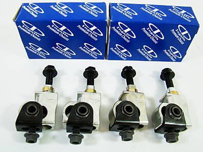

any long term reviews on these with the tl? ive heard less than desireable reviews on the longevity of the balljoints from these style kits. no personal experience, just shit ya read. these always seem to be priced right compared to just the balljoint replacements.
any one have top views of the stocker a-arms and s2's side by side? any differences? I ask cause ive seen side by sides with other honda cars and the s2 version had less swept back arms which takes away what little caster the car had to begin with.
looking at the first pix of the ingalls kit. the nuts on the top of thier kits are tall. the similar spc kits have a low profile nut (about half the height) on thiers.
the older spc kits used to have the same tall style nut on thiers and converted to the lower profile one. Ingalls could have done the same in recent years. the lower profile nuts would help keep the slap down. ive pushed a set of these nuts through my upper shock towers before, lol.
Ive used the spc's for years with no complaints, but have read reviews that these style camber kits tend to bind at the end of the suspension range and that the ingalls anchor style kits are actually a better choice.
Ive used these too for years with no complaints/issues. I just switched to the spc balljoints cause it was easier for the techs where i get my alignments, but after reading about the bind, Im switching back on the cars that I actually race. whatever you do, DO NOT use the spc anchor style kits. those are garbage. heres a pic for reference.
***again, stay away from the SPC anchor bolt camberkits***
