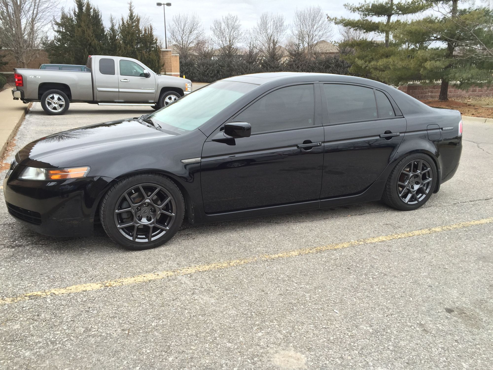

Those are type s replica wheels and yes, they are new. I am currently on a set of these wheels with the oem tire size, 235/45/17 and they look great. They will mount right up no problem as these wheels are the EXACT same specs as your factory wheels, 17x8 +45 offset, and you can transfer over your tpms and use your factory lug nuts. HOWEVER, keep in mind these are replicas and not OEM. So they are going to be a bit heavier than your factory wheels. If you are not planning on taking your TL to the track, they should be just fine. :thumbsup:
There are a few people here on acurazine that have these replicas, maybe some of them can chime in. I have had mine on for almost a month now and love them! Yes, they are heavy and I have noticed that my TL's acceleration is not quite as quick as it normally is. But last time I checked the TL is a HEAVY LUXURY car and not a race car. If I were you I would get these and don't look back! Here's how my 06 looks with these replicas
https://cimg7.ibsrv.net/gimg/acurazi...ab3fb07a7a.jpg
