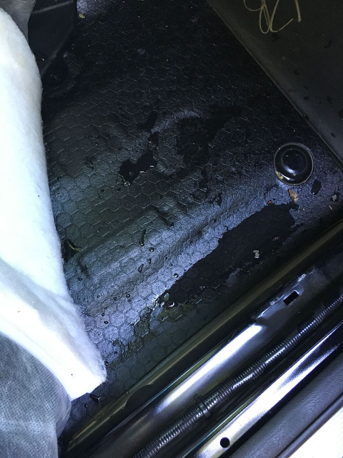

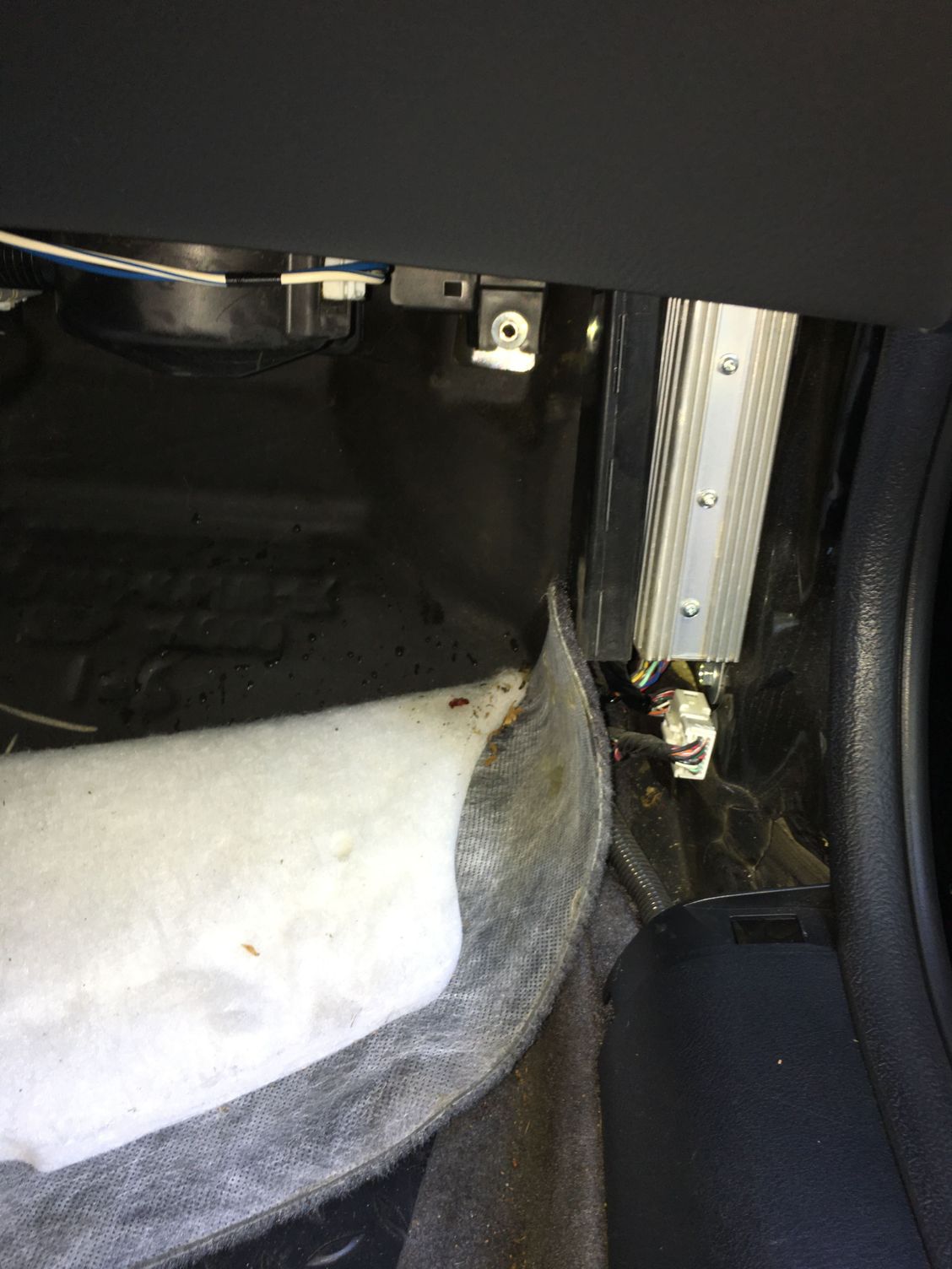

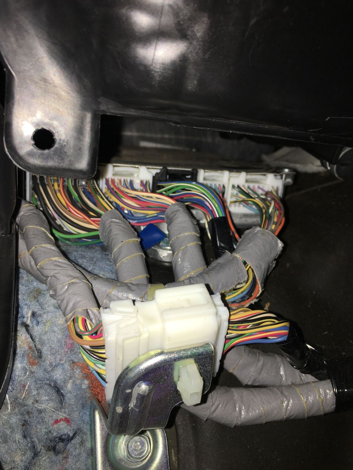

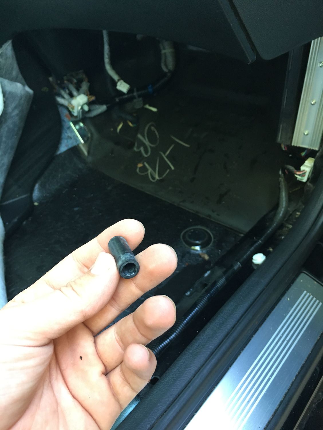

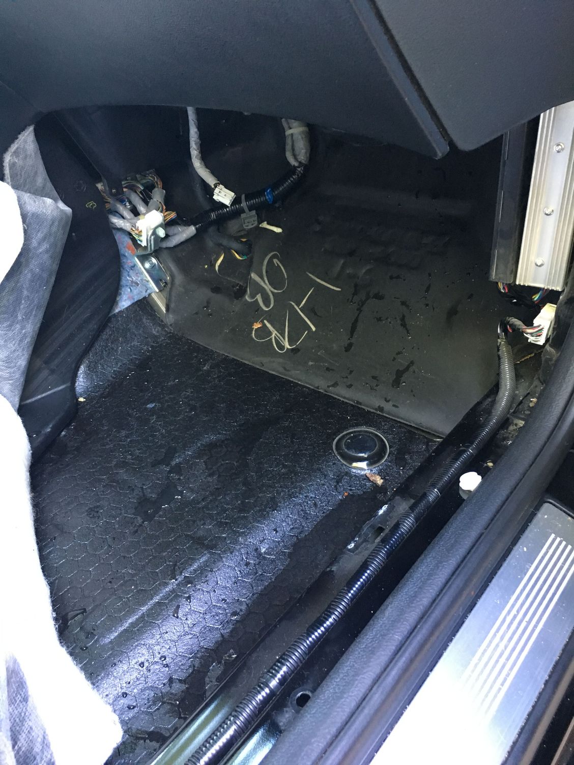

i know a lot of people said the AC leaking/ being clogged would be the culprit of my melted coil however the plug was loose which i thought was the issue.. i never felt any wetness until today... my ac randomally started going slower so i turned it off and noticed water leaking where the passengers feet go, straight ahead, if it is clogged, how do i unclog it? can i still drive my car? I hope the ECU didn't fry and it just missed it or something, I touched what I believe is the ECU and what I believe the PCM and they are dry. Here are some pics of what's going on. I also found what looks to be a plug that could possibly hold water in.

https://cimg2.ibsrv.net/gimg/acurazi...ba12fb3083.jpgguessing is ECU (behind radio) dry
https://cimg3.ibsrv.net/gimg/acurazi...65b9962d52.jpgguessing is PCM on side .. dry
https://cimg4.ibsrv.net/gimg/acurazi...500a13ed8e.jpgsome water leakage
https://cimg5.ibsrv.net/gimg/acurazi...15d4e5fe30.jpgmysterious plug found
https://cimg3.ibsrv.net/gimg/acurazi...0c685ea5e6.jpgwater found under the carpet

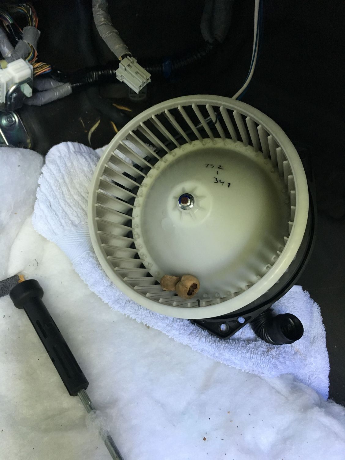

update: found 2 acorns in here.. wtf https://cimg7.ibsrv.net/gimg/acurazi...ceb0303083.jpg2 acorns found
nfnsquared Jul 2, 2017 02:11 PM
FYI, the ECU and PCM are one and the same. Technically, I think one is for the MT, the other for the AT, but not sure about that.
The drain tube is in the engine compartment near the firewall on the passenger side. You'll have to access it from underneath the car looking up.
You probably had mice or some other small rodent living in your A/C ducts. Have you pulled your filter yet? Better check that.
The drain tube gets plugged from the bottom, usually road debris or a spider building a web/home in the end of the tube. I doubt the rodents had anything to do with the blockage.
If the engine is running fine, then you might be lucky. I wouldn't put power on the car until you can get the tube unblocked and everything dried out. I'd run a fan on the ECU area for a few hours.

which filter? i have a CIA, and where abouts is that tube? is it as simple as pulling the tube out and letting the water pour out? possibly need an air compressor? and like i said those parts are all dry.. i don't tbink anytbing linked on the computers .. the leak stopped when i put the piece back in and took acorns out, u think i still need a good look?

cabin air filter, behind the glove box. you might have a ton of acorns sitting on the top of it....

The drain tube is that rubber hose running into the floor. Get a shallow bucket and yank that rubber out from the passenger side floor and take a compressed air to from the mechanics shop. You can try putting a flexible firm wire in there too incase it's clogged up. The air and the wire should be the best bet to clear anything if clogged. If it is indeed clogged, be prepared for alot of water.
justnspace Jul 3, 2017 07:10 AM
that is the factory AMP for the radio

lol feeling like a noob, thanks for the replies, will try ideas and update, however was I correct about my ECU location? All I care about is that thing being dry right now lol
justnspace Jul 3, 2017 08:45 AM
yes! Under the radio is ECU!!!

Dunno, I'd be careful about "yanking" the tube out. It might be difficult to thread it back through the hole. I'd probably get at it from under the car...

i pulled mine out and put it back in no problem. It's a rubber hose and easier to put back on than the gas cap. It's not held in by anything, just pokes through a rubber grommet. Saves the trouble of raising the car up.

I was about to try all these ideas and i prob should just for the hell of it anyways but when I took those acorns out and properly place that part under the dash back in i havnt had one singe drip.. there's a little hose about 1-2 inches long on it.. starting to think it just slipped off or something ...meanwhile on the other hand i can't escape the bullshi* now.. got the ol' HFL booting up signal.. tried a reset, it worked until i started the car again..car has 112k on it so i figure it's starting to lose some of its original glory.. guess only option is to look on ebay for some HFL modules ? thanks again for help guys
nfnsquared Jul 4, 2017 08:20 PM
I'd still check the drain tube....
