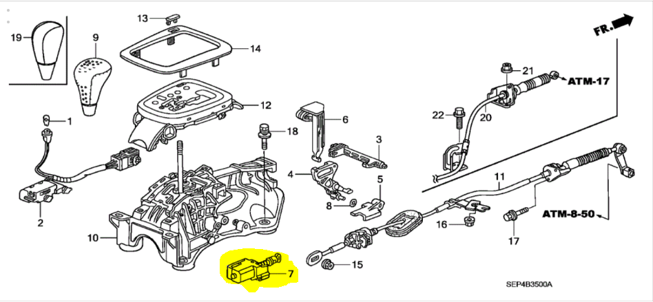

See thread title. My 2007 Base has been doing this thing where it won't start when in Park. I have to override the shifter and put it in Neutral, and then it starts right up. The alternator is brand new. This issue does not ALWAYS happen, but seems to most frequently/consistently when it is rainy/wet.
Has anyone ever experienced this? Any ideas on source of problem and how to fix? I'm stumped. Thanks in advance.

Shift lock solenoid

This ^^^^

Huge! Thanks a ton, I will get into it.
