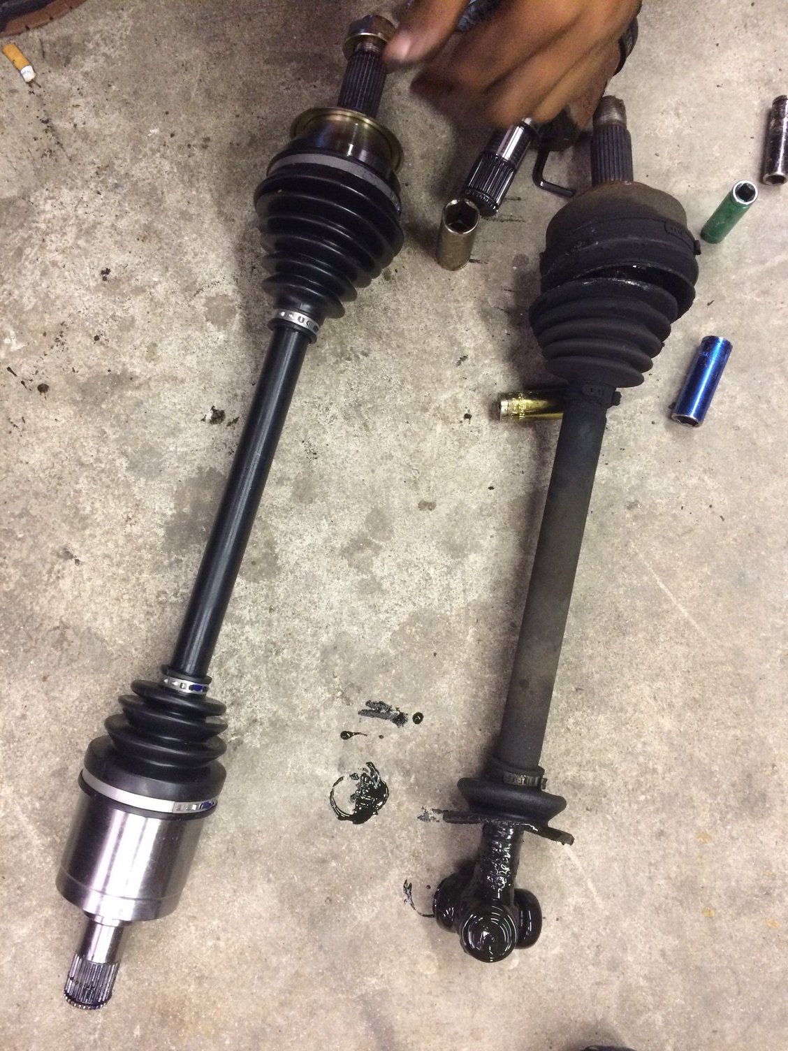

**UPDATE** Issue has since been resolved.
I changed the axles with some used OEM ones and they are fine. I had to unfortunately change the intermediate shaft because the installer jammed the right axle on the shaft, and it had to have fused together. Used heat, and impact hammer, and ended up breaking the intermediate shaft bracket.
Before the bracket broke, I noticed the bearing had grit, and a lot of play...
Therefore I have a whole replaced axle left to right...Also, Advance Auto Parts axles are absolute ass...The inner CV joint separated within 3 weeks. Didn't get a chance to fix ball joints and tie rods, but this has fixed the issue. Just a heads up to anyone considering GSP (advance axles).
Oh yeah, and the inner joint is still stuck to the old intermediate shaft. I am going to contact Advance for a full refund. They caused me more trouble than good with these axles.
