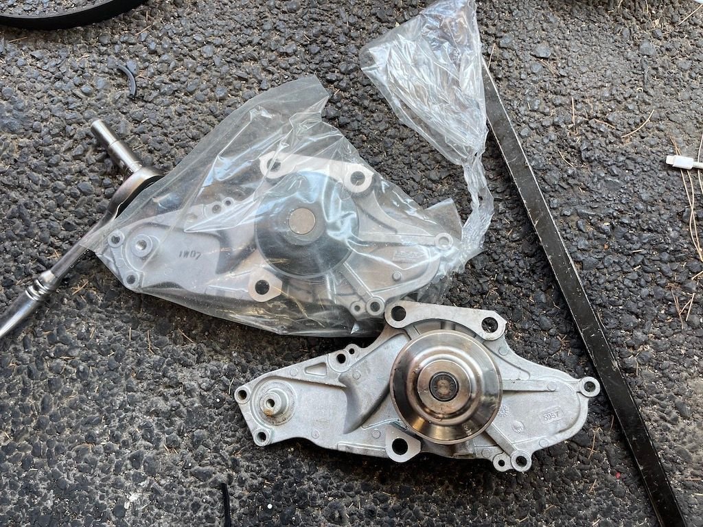

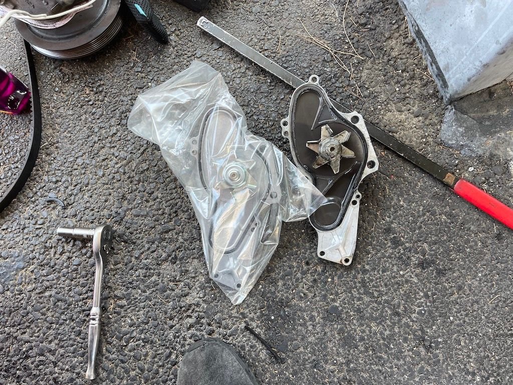

First of all I bought this Aisin TKH002 timing belt kit from a reputable source, a well-known online retailer starting with "R". I kept the factory parts replaced out of another vehicle several years ago so I compared them side by side.
1. The Koyo bearings looked "Made in Japan" quality, smooth and polished.
2. The belt had "Mitsuboshi" and "Made in Thailand" printed on it, it looked okay but definitely not refined or polished. The stitch that sewed the ends together was frayed at the end instead of a clean cut.
3. The workmanship on the hydraulic tensioner looked rough and had an incomplete "AISIN" paint mark. It did not look like coming out of a Japanese factory.

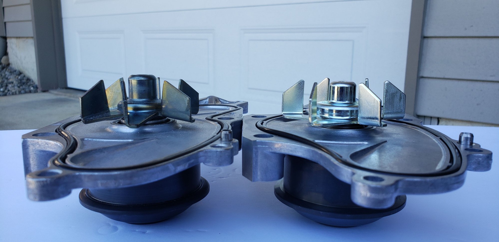

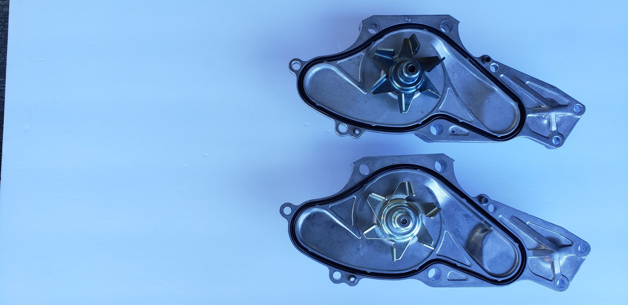

4. The water pump looked most suspicious. Despite the shapes and features of the aluminum cast looked the same, the new pump had quite a few rough spots, the "AISIN/JAPAN" plate looked shabby with rough edges. The impeller had different shape and size.
Other than the Koyo bearings, I didn't see typical Japanese fit and finish on any of the other parts. What do you think? Could this be a counterfeit Aisin kit or just an Aisin kit of "aftermarket" (inferior) quality?
Top: factory Bottom: new
Left: Factory Right: new
Top: Factory Bottom: new

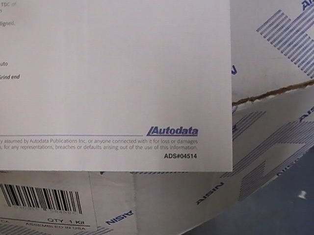

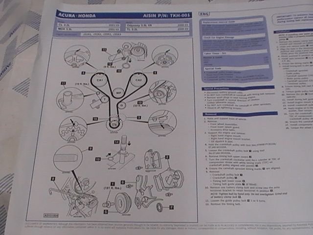

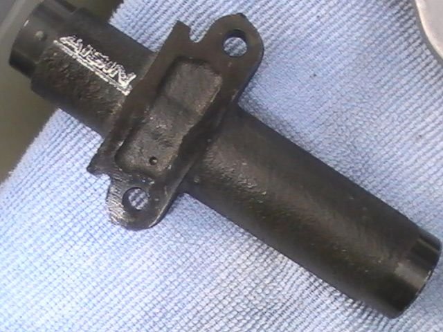

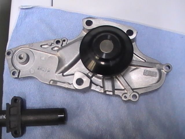

Here are pictures of my CL-S6 Aisin TKH-001 kit I purchased BEFORE the supply chains were ravaged by COVID in Dec 2019.
I am entirely confident it is the REAL DEAL:
Same rough casting & 'white' rubber stamping on the TB tensioner.
Same AISIN water pump logo
Aisin packaging
Autodata instruction for models compatible to take the THK-oo1 kit
The TB is not pictured; however, it is a Mitsuboshi CD286; made in Thailand.
If you can reconcile any of the above with what you received from RA, then, IMHO, it is reasonable to assume you
have a genuine AISIN kit;

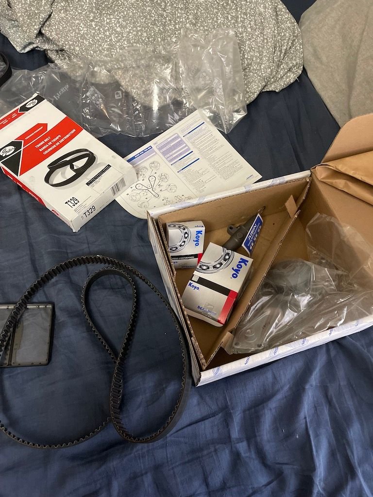

I got the same TKH-001 from RA, for my own piece of mind I ended up purchasing a Gates belt separately and using that instead of the one that came with the AISIN kit, im already 3500 miles into the kit and so far so good no issues
Old Jul 24, 2022 | 10:55 PM
bohrhe's Avatar
Joined: May 2014
Posts: 41
Thank you for sharing, @JRey
Was your Gates timing belt made in Japan? How did it compare with the Honda OEM belt if you had a chance to compare?
