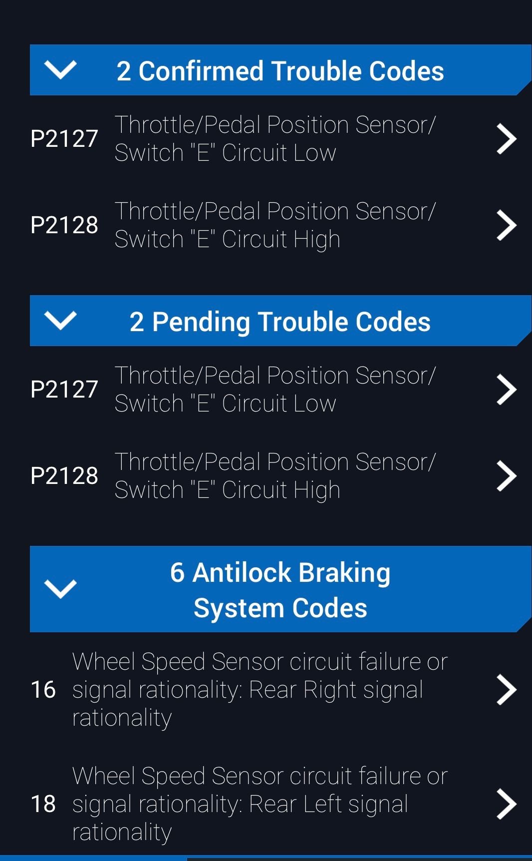

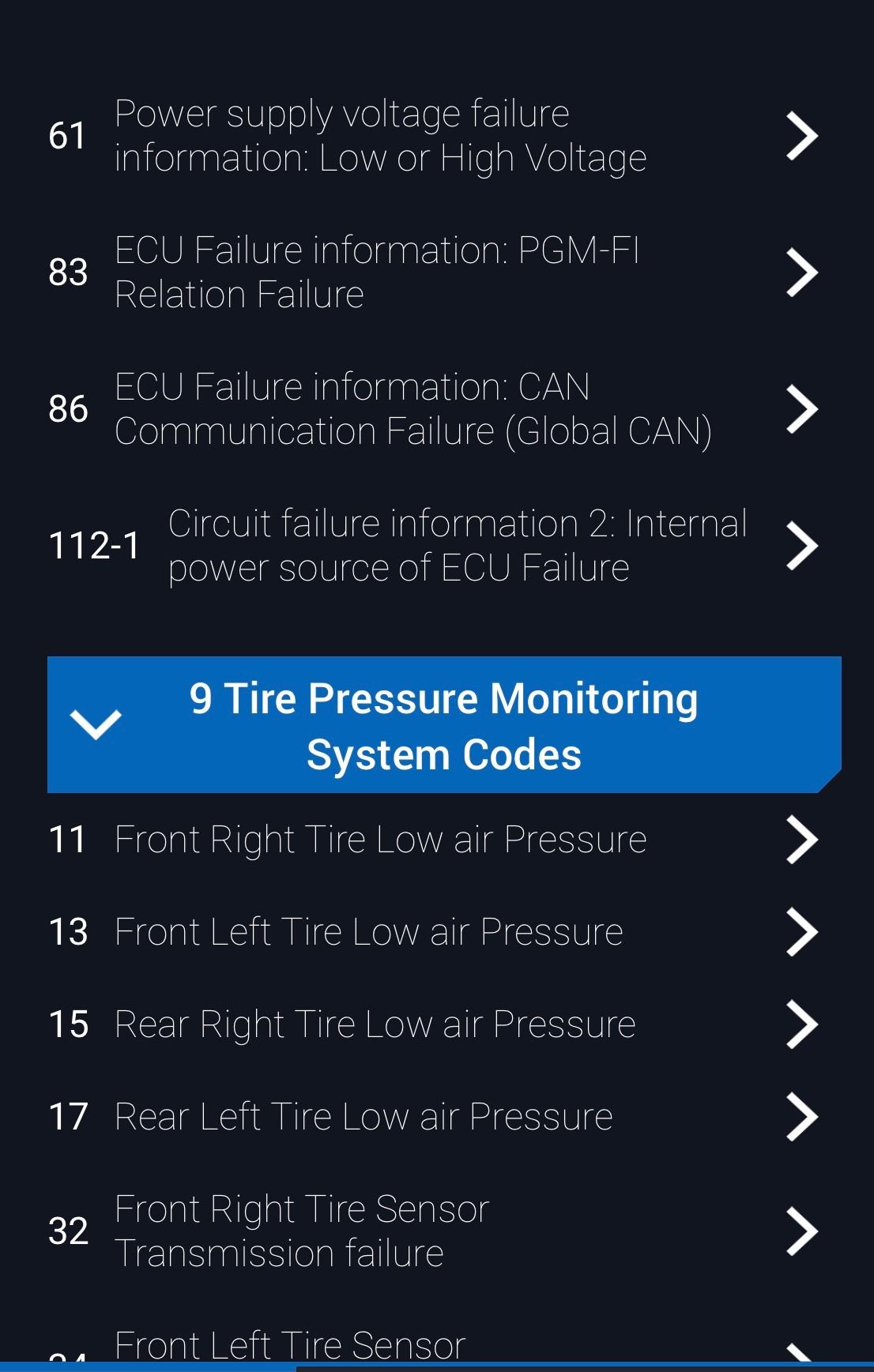

After doing the reset i had all the lights on so i scanned the modules entire car and recent faults.
Throtle Postion sensor code came up which gave me clue on why. As you said Slpr04UA6 recheck the top engine strut stabilizer bar i removed in my work with the upper control arms. The bar has TPMS sensor attached to the bar which i removed the fastener. While it was put back i didn't notice the TPMS sensor was slightly unplugged from working on the car. Duh... So i refastened the other bar bolts ECU better and TPMS sensor which are connected with clamps to the strut tower engine bar.
After restarting the car VSA lights were gone but check engine stayed on. With the Bluedriver OB11 scanner i erased all codes.
After the code erased the check engine light is not on. Success!
