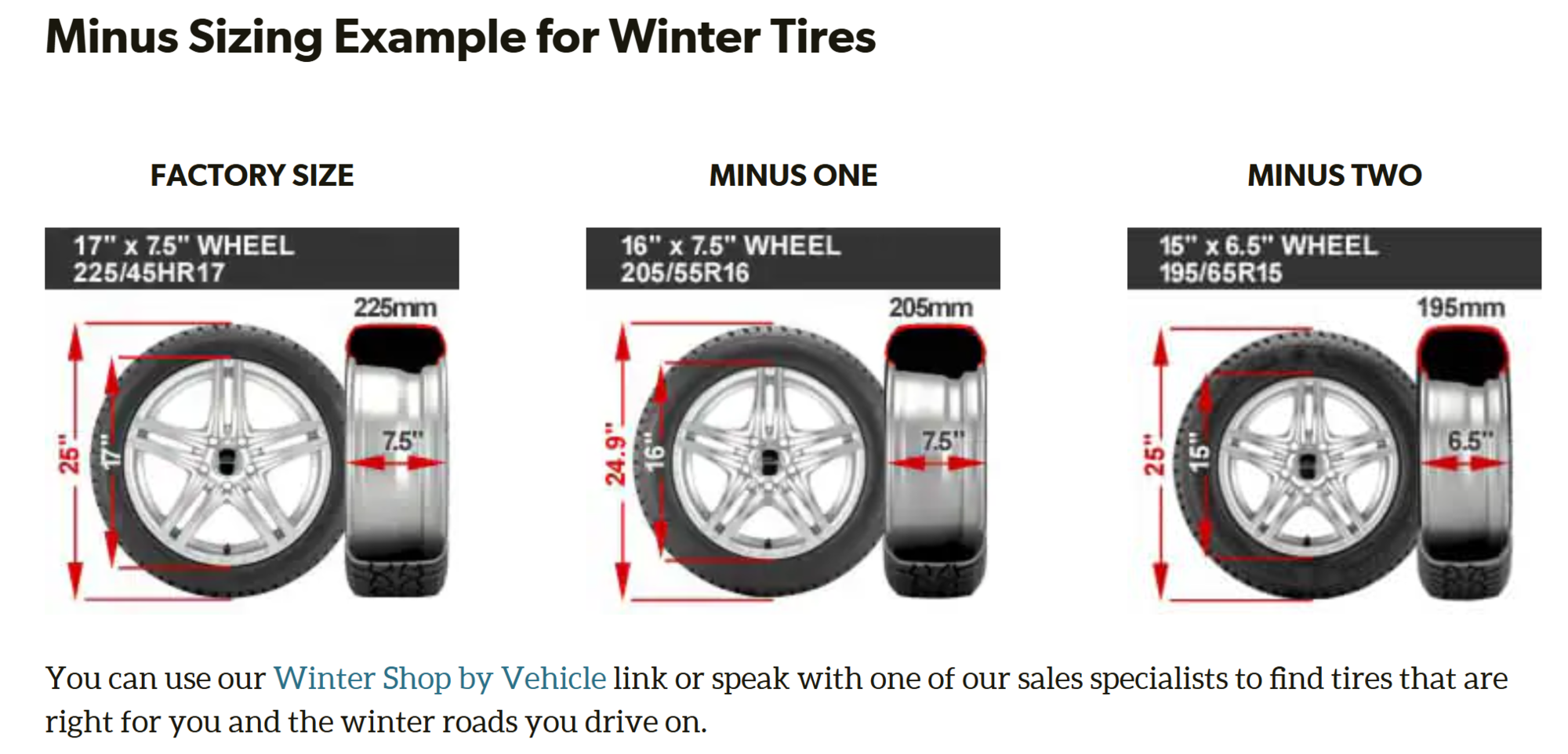

www.tirerack.com is a wealth of information, so you may want to spend some time researching there - specifically Minus sizing. Below is a snip as an example.

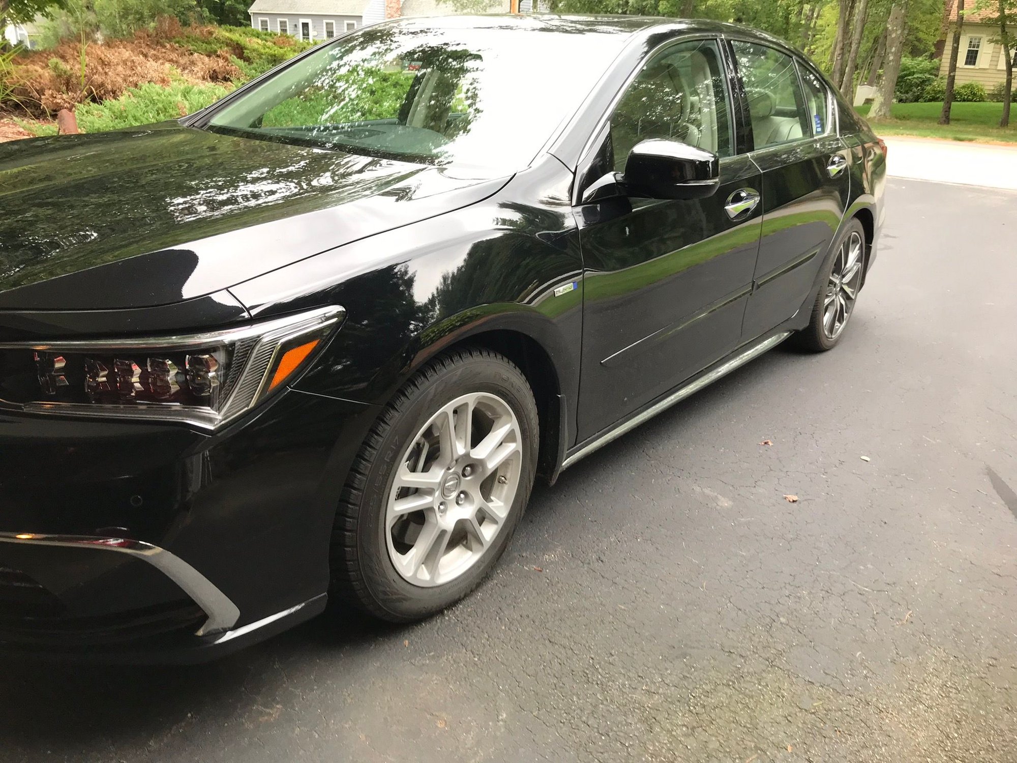

Yes, 17" wheels will fit the RLX Sport Hybrid. I run them on the wife's 2018. Tire size equivalent is 235-55R17. If you go to tirerack.com and select a winter wheel/tire package, you'll see the specs for wheels and tires for different sizes that will fit the car. The 16" wheels won't fit - 17" is as small as you can go and clear the calipers. I live in NH and run winter wheels/tires - and have the OEM size for the other 3 seasons. But if you want to run 17" wheels/tires year-round that's certainly possible - just make sure the tire size is the one above so you get the same overall diameter of the wheel/tire combo.
attached is a pic of the RLX with the OEM 19's on the rear, and a set of TL OEM 17" wheels with snow tires on the front - so you can see the general difference.
