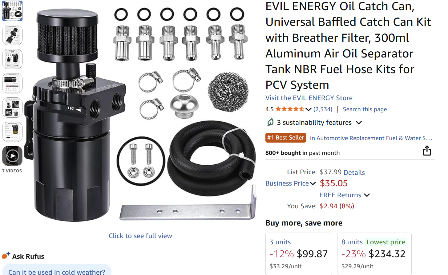

I installed one on my 2014. I used this one https://a.co/d/7RflDZd. I used the bracket and mounted it in the center area above the radiator; I used the bolt which mounts the radiator shroud and the fan controller cooling block. You might want to get a slightly longer M6 flange bolt to replace the original (Think M6X20 works). From there, use the supplied 3/8" hose and get about 3 feet of 1/2" hose for the PCV outlet hose. I'll supply pics if needed. DO NOT USE THE BREATHER FILTER ON THE TOP OF THE CATCH CAN.

Can you double-check that link? It takes me to a "SuperOffers" website.

My bad. It is a Evil Energy 300ml catch can on Amazon.
