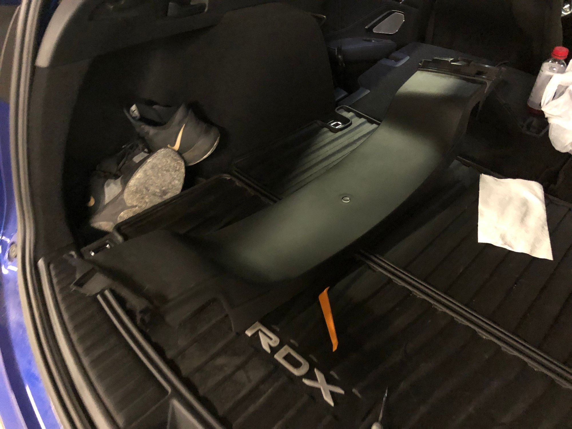

So I’m in the process of installing a rear dash cam, I previously installed the remote start following the instructions step by step.
Well i I have found a way to install the remote start in about 30 minutes TOPS. There is in fact a safe and easy way to get the top panel off that you need to get access to where the receiver is installed. You can actually peel back the side panels enough to easily remove this panel, and there is just as much room to install the receiver as ripping apart the entire back end.
I think Acura could easily change the instructions and save the dealers hours of time doing the installs. If I were to install it again now I could do it easily in 30 minutes!
As proof:

Did you have to use the mallet to pop the front clips or did you just unlclip the trim enough in the back?

Nope no need if you do the new method, don’t even have to stress the clips up front they can stay complete locked in

Thanks for the pictures!!!!! Is there a write up on this or any tips or tricks? Getting ready to install my DOD dash cam, thanks.

if I decide to upgrade the cam then I’ll make a video with tips but so far this one is fine
The entire headliner is held in my magnets and this industrial velcro type stuff, don’t be afraid to pull it down, I ran my wire along the rear wiper washer line that follows the sunroof opening on the passenger side of the vehicle, it really isn’t that bad to do once you learn how things come down, also the rear wiper washer line goes into an opening through the right side rear hatch arm holder thing, zip tieing to this line makes sure you won’t get it pinched. Also when you open the hatch, the middle part that is in the interior at the top of the window is part of the hatch, it is not a panel that you can remove, it is the hatch, but the side panels come off fairly easily

I used your method, so that I could run the dash cam cable, and it was a success. The only issues I had, is that the top cover now shows some scratches from getting it out and I ruined the panel plug that goes on the side of the hinge cover.
