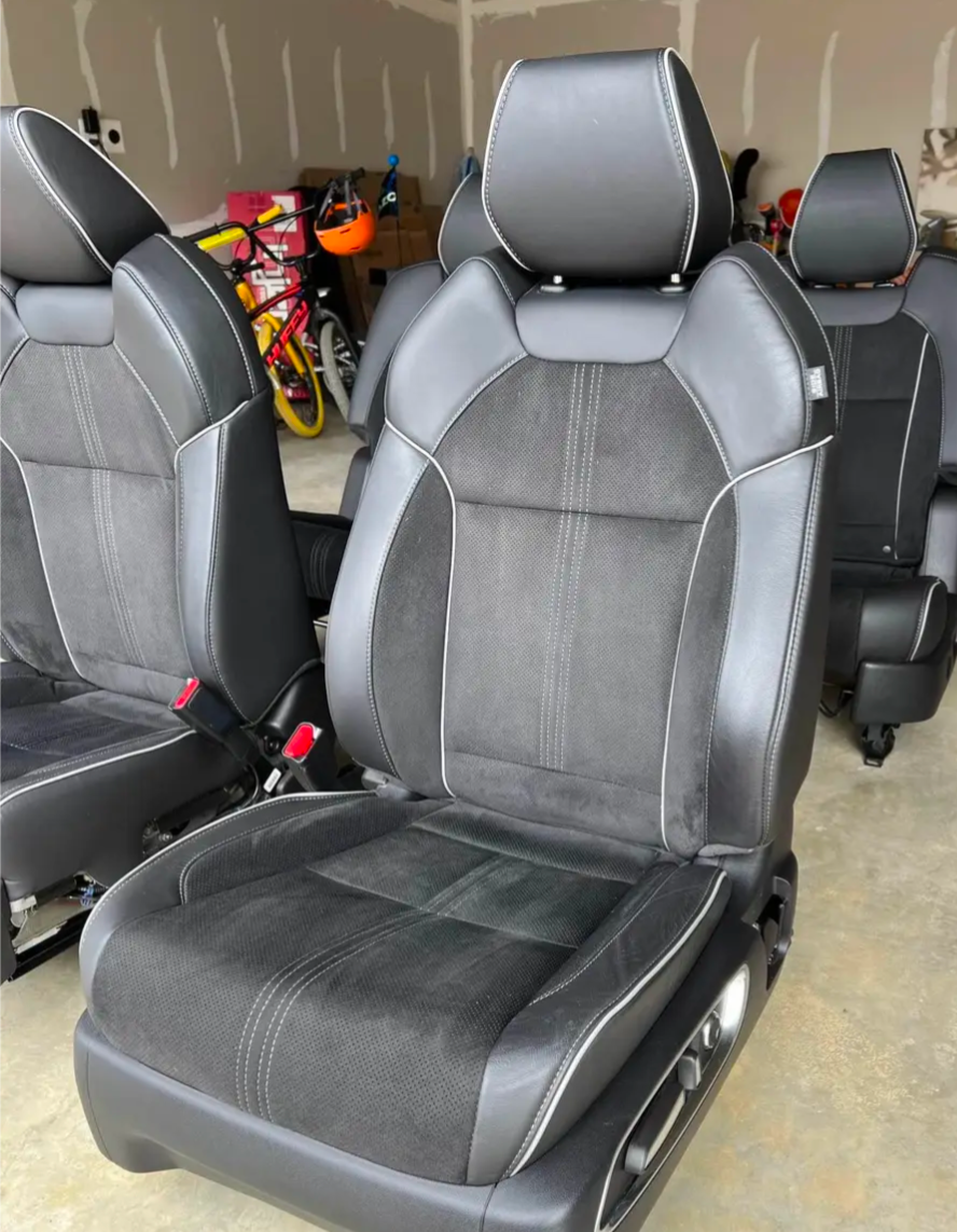

Looking to do a few things to make my 2015 SH-AWD more comfortable (in my mind) as I plan to push it for another year or so.
I've found a seller with set of black aspec seats. Would they fit my 2015 without any modifications? If not, what would I need to be prepared for?
Thanks in advance

Need to look at the seat mounting. See if it's the same. Next look at the plugs. If they match up it will probably work. Worst case would be moving the harness and airbags over. Or maybe taking the cushions and leather over to the old seat frames. I had to do that with my 2018 f150 when I changed it to the lariet leather package.
