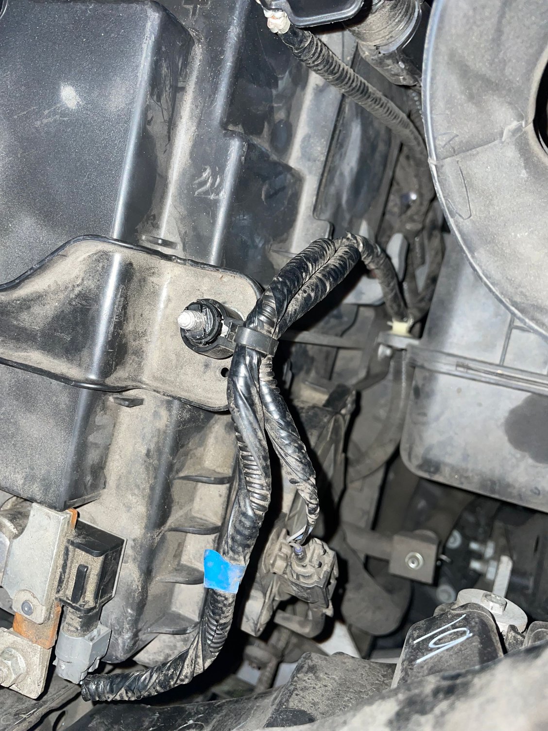

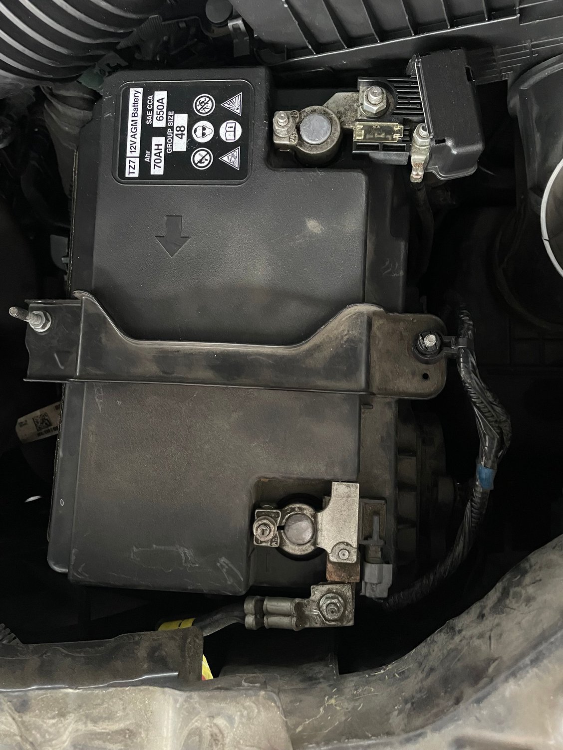

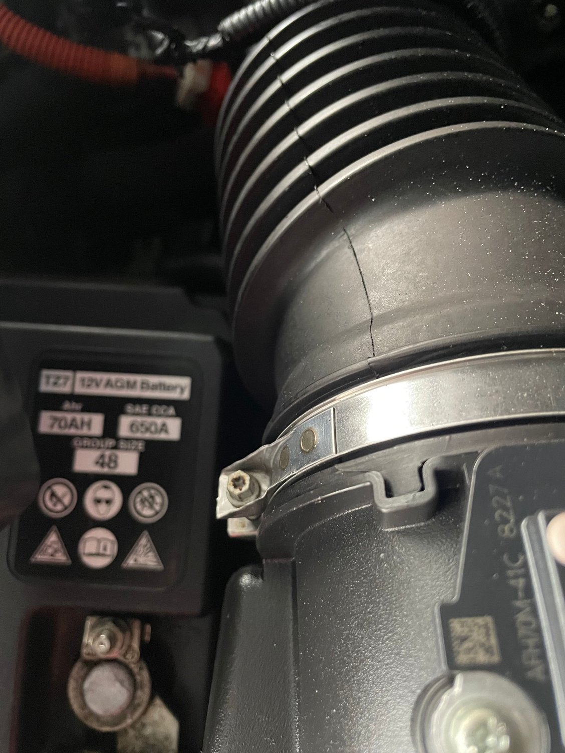

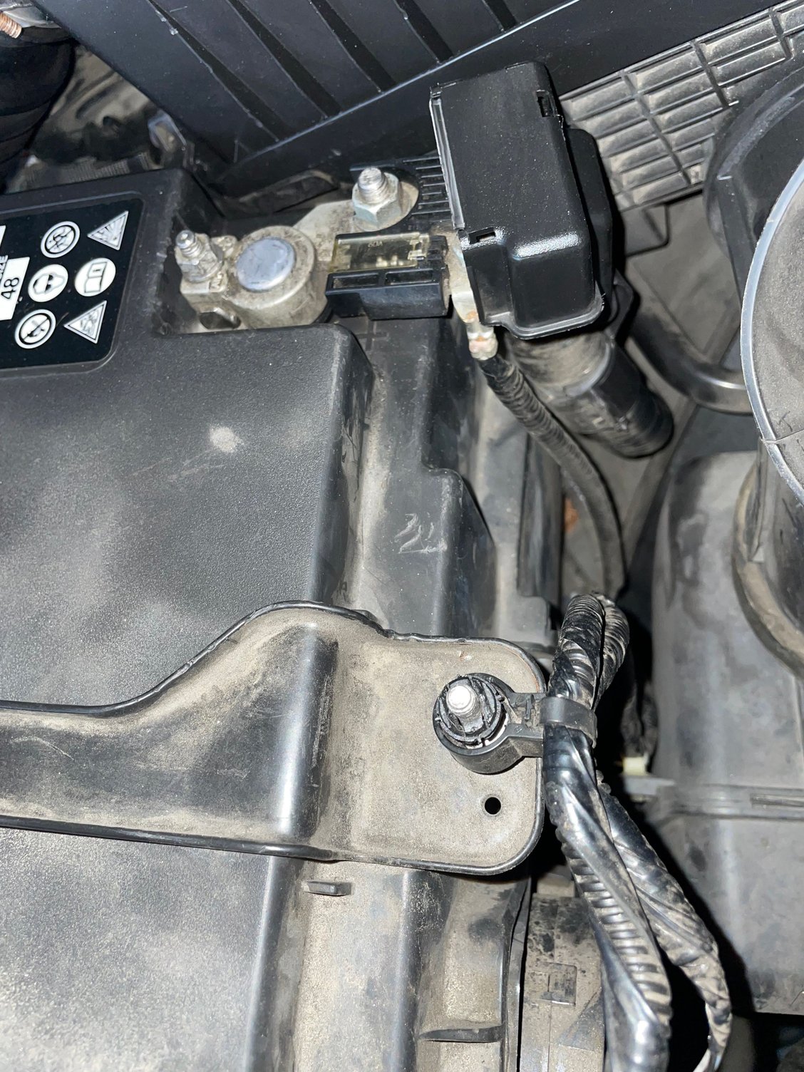

Just wanted to show tha my 2018 sport hybrid also has agm battery. I was looking for a date sticker but didn’t find it. I wonder if it is OEM still considering this car only has 31k miles at the moment.
interestingly, I noticed a bunch of modules attached to the side of the battery. I don’t remember seeing that in my 14 MDX. I wonder if it is specific to sport hybrid or agm batteries.
anyone know how to tell if a battery is Acura supplied?
side note: I checked the 10mm nuts to the terminals and I was able to make a several revolutions before it became tight! I wonder if that was what’s causing all the random electrical gremlins.
examples include emissions system light/electric parking brake light that threw a p0420 code and disappeared after a longer drive; car automatically locks car within 5 seconds after unlocking car at random, in the mornings; blind spot monitoring in driver side was flashing one time instead of full solid and passenger side works sporadically unable to trust it; I’m still new to the car but noted engine still running when was expecting EV mode while in certain normal IDS mode presumably to charge the battery?)

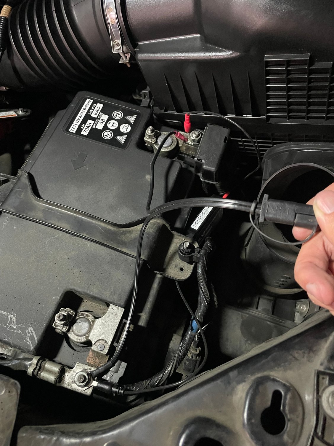

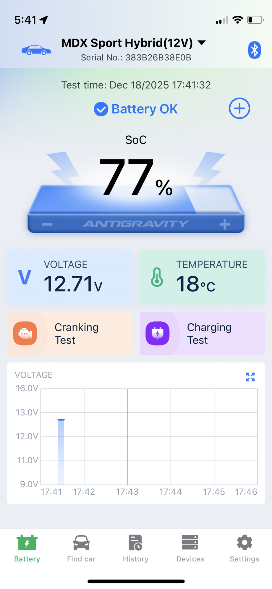

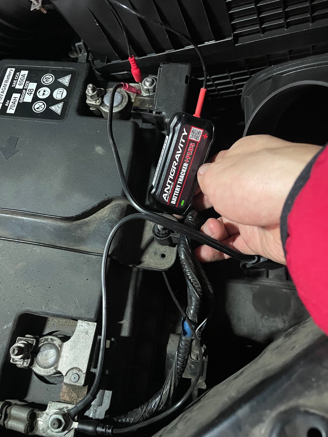

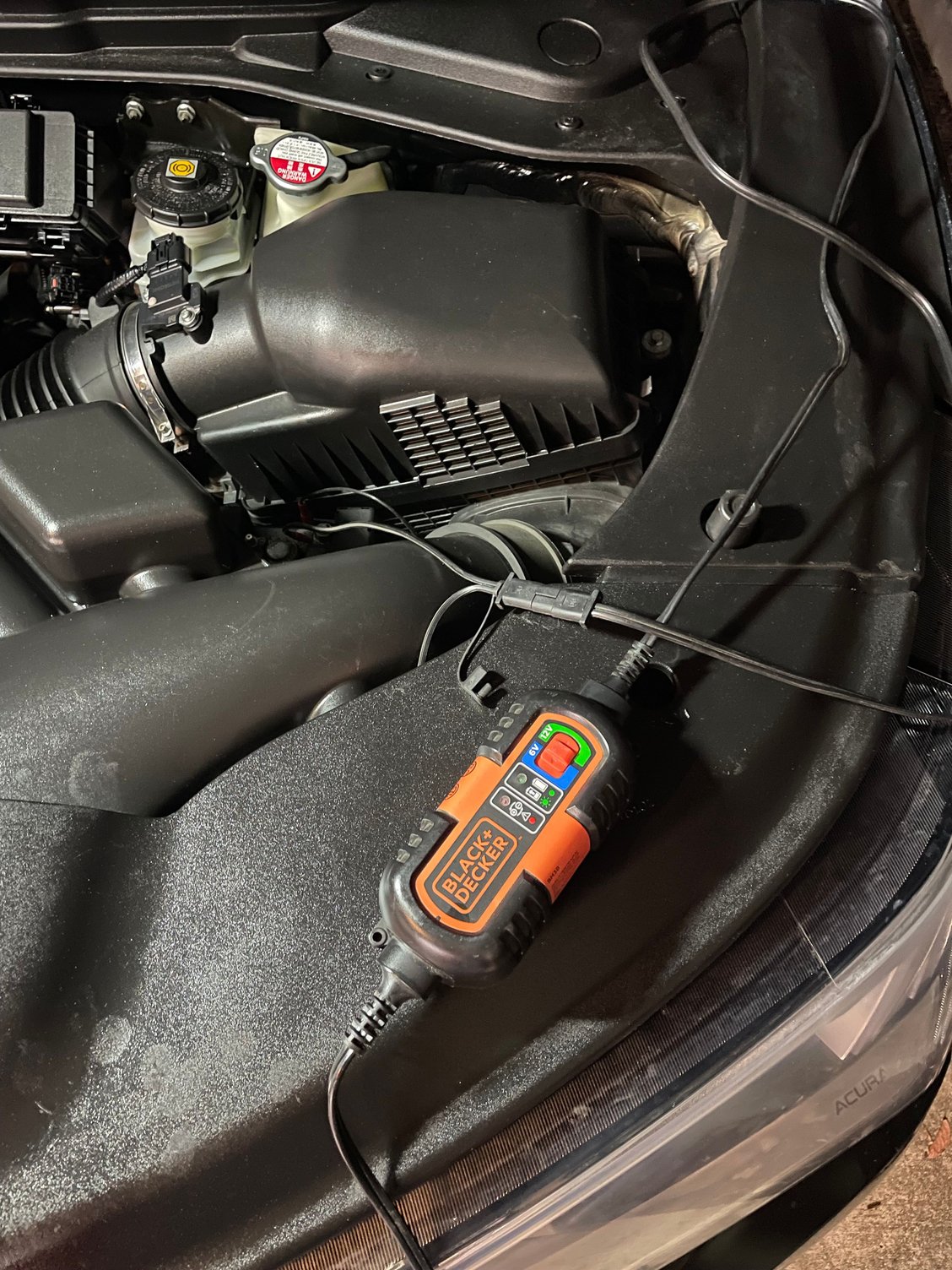

Bluetooth battery tracker and wired trickle charger
So my sport hybrid been showing interesting symptoms first thing in the morning while the car gets parked outside overnight in the cold. I know these AGM batteries can be expensive so I decided to trickle charge it and I have not had the symptoms thus far. So I decided to wire in the trickle charger quick connect to keep it in tip top shape and also monitor the battery status through Bluetooth tracker app.

Not sure why Acura changed from AGM for the 17-18 MDX SH to Lead-Acid 12v for the 19-20 MDX SH? I figured it was A-OK to upgrade my 19 MDX SH to AGM because the 17-18 MDX SH came with that type of battery. I changed out my OEM lead-acid 12v on my 19 MDX SH at +53,000 miles with the Costco AGM H6 (48) back in Apr/24. No issues with the OEM 12v and I just wanted to do a preemptive strike after +5 years original battery.
