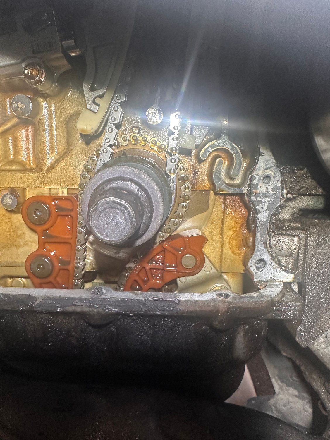

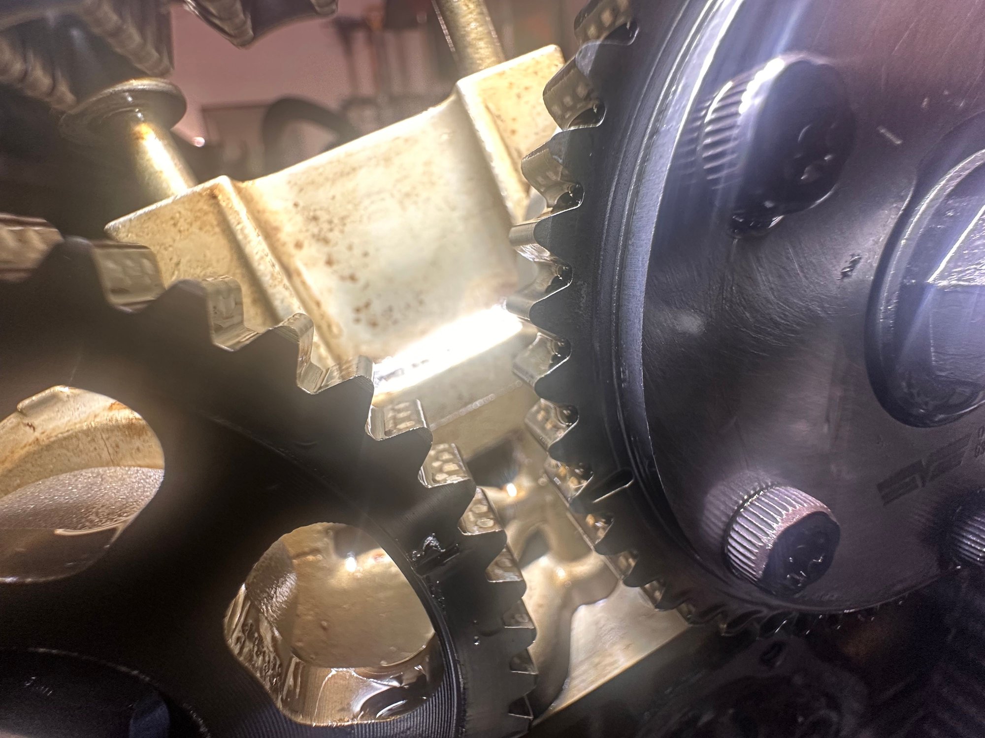

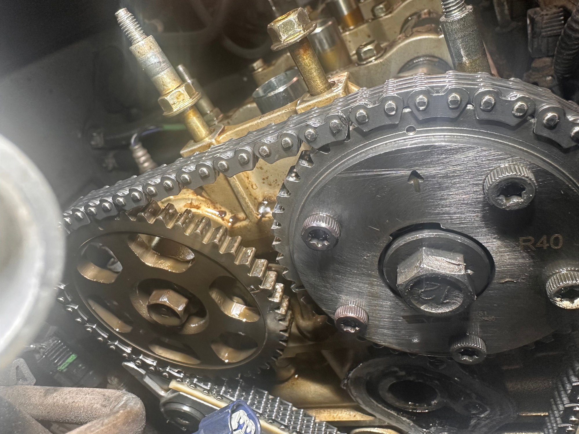

Well I decided to take it back apart and try it again. I do believe the noise is coming from the lower chain since I’ll admittedly say I didn’t do it because I didn’t want to pull the oil pan but now here we are again. But I am worried about the timing. I put an aftermarket vtc cam gear on and I don’t think they are lining up. I do have both cams pegged with the cam plugs but as you can see the timing marks are off a bit. Also on the bottom it’s not lined up either. Can I turn the bottom so it lines up and be ok? Any other suggestions while I got the chain off to ensure I have the timing right.

I bet your engine doesn't like that dorman VTC actuator... try replacing with a Honda OEM part.
