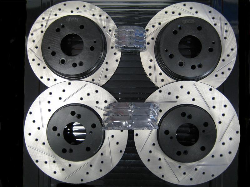

looks amazing! but outta my price range...this kit is more my speed....
http://store.excelerateperformance.c.../i-466578.aspx
or this....
Attached Thumbnails anyone make a complete front and rear bbk kit-143114ca-bdbb-4d86-9b0a-ec9a3dcc6f2f-800.jpg
