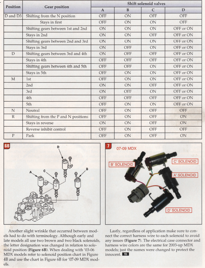

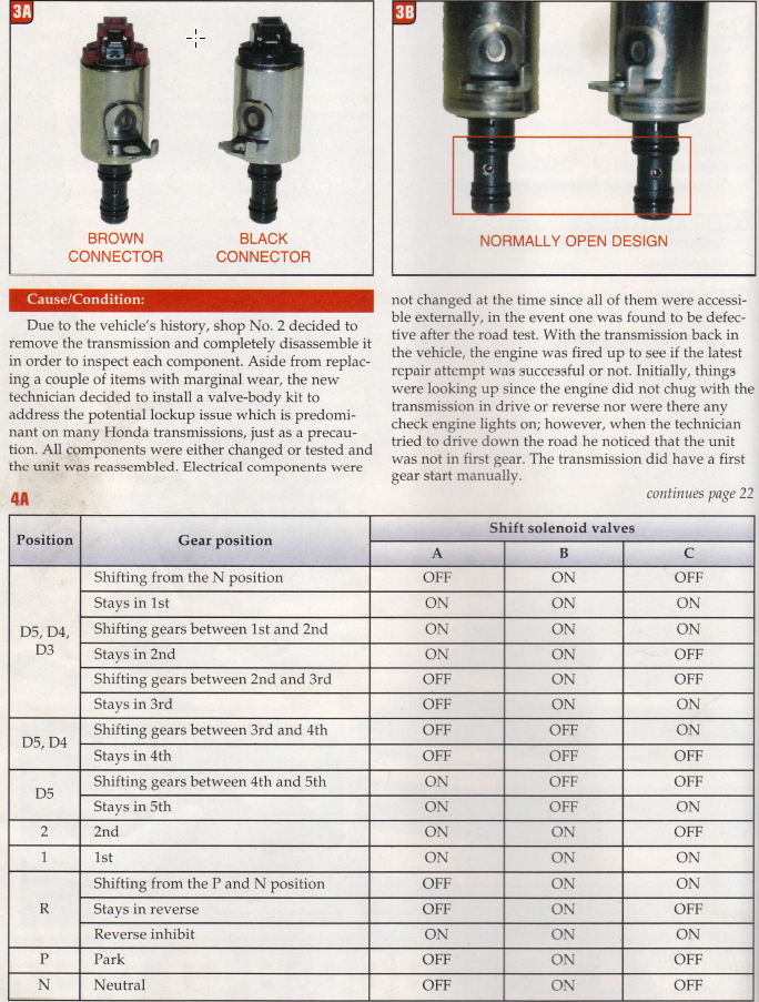

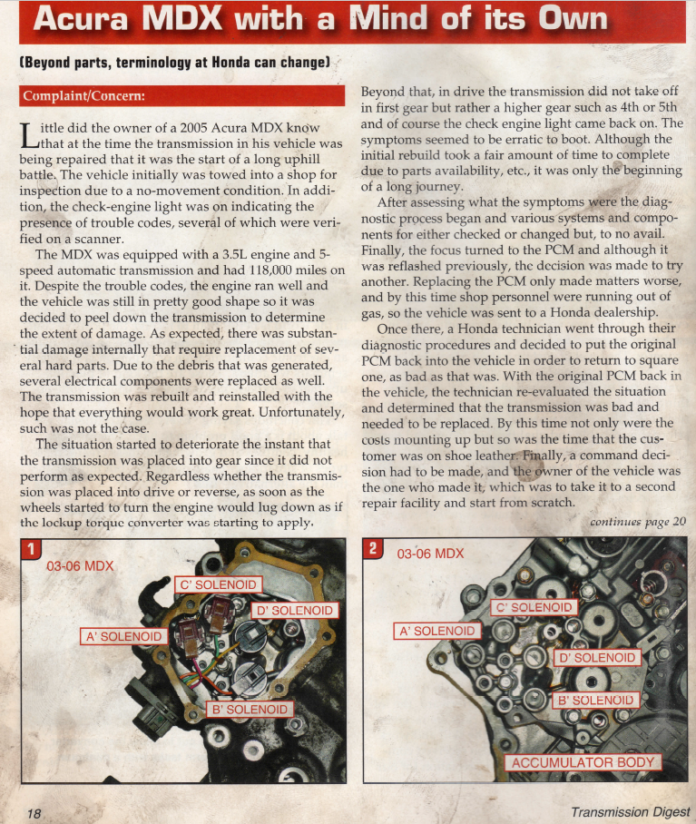

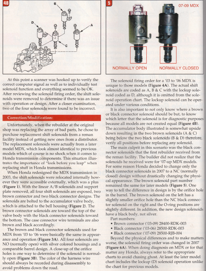

A while back I promised to post some information concerning our transmissions this information came from Transmission Digest and help explain some issues some people have when rebuilding their transmission. Some of the information is specific to MDX and some is generic to Honda and Honda Transmissions. I am posting to hopefully help someone having issues. I was going to post on the main transmission replacement thread but was not sure if it really belongs there.
First Page of article
