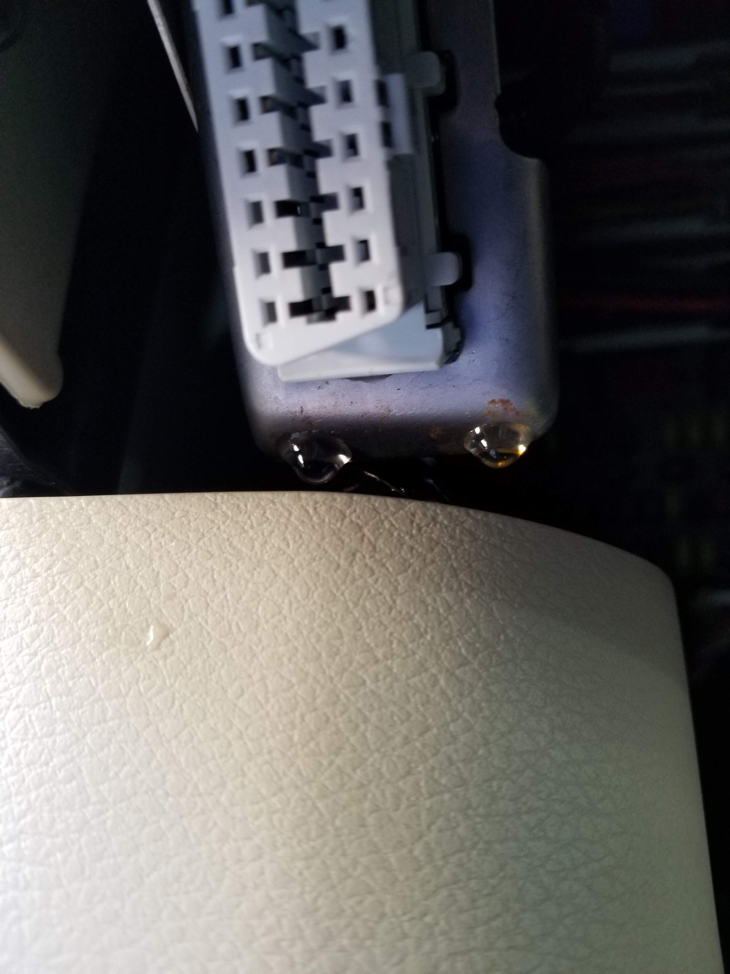

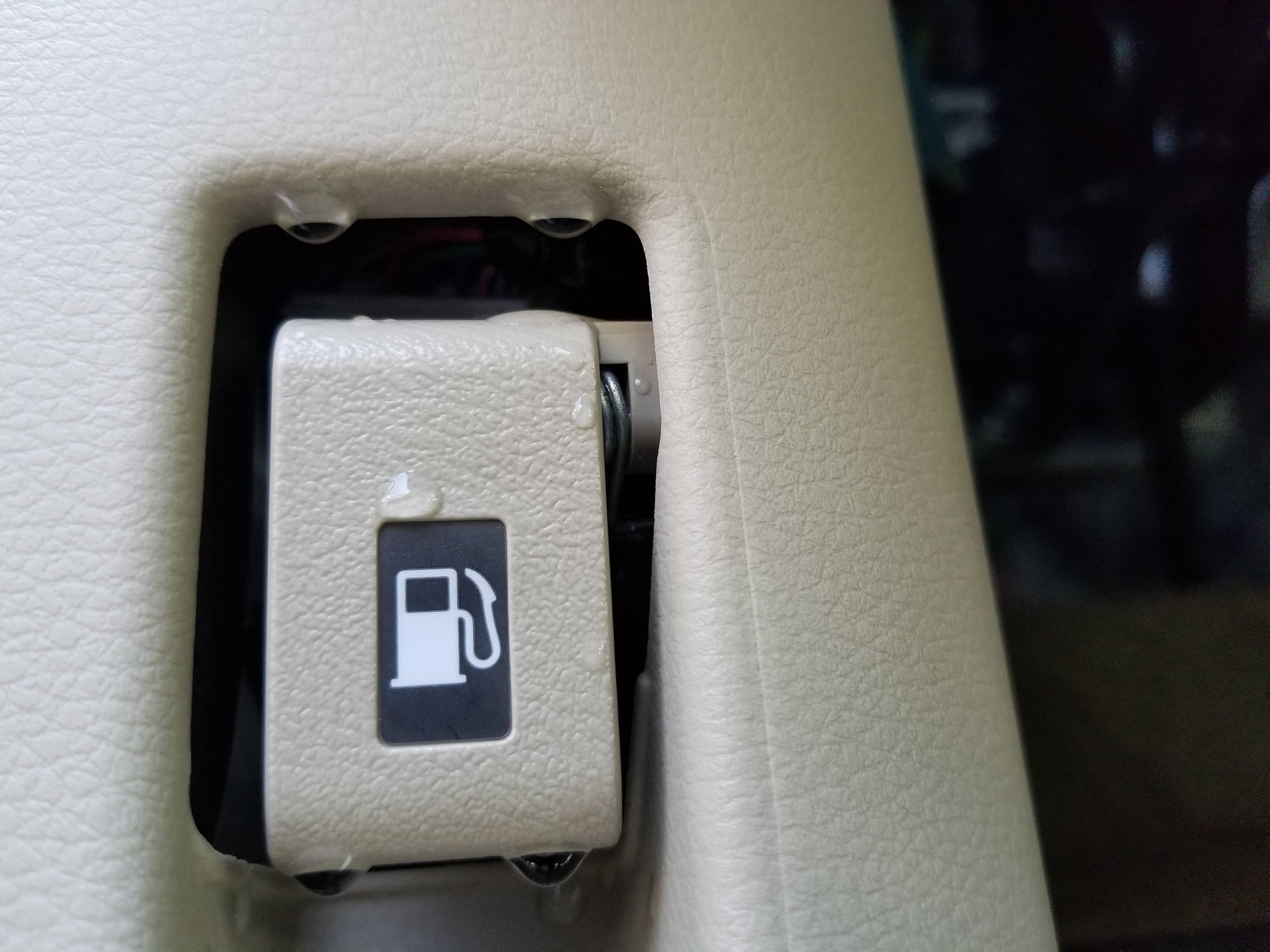

For 2.5 years our 2018 RDX w/tech pkg has been trouble free, but now it’s a car owners worst nightmare. With recent heavy rain in Southern California, and because of the shelter in place orders, the car is parked in the driveway collecting rain water...ON THE INSIDE! It’s rained a few times since we took delivery, and no issues, but now a small puddle shows up on the floor of the drivers side after a heavy rain. Windows have been closed, no windshield replacement ever, no open sunroof. I’ve taken pics of water dripping from the onboard diagnostic plug-in, and also the fuel door release. The first time it leaked was in a downpour in March and, like this time, it caused electrical issues; horn goes off, warning lights showing open door, and not able to remotely lock the car. Water is coming in from somewhere along the A pillar, but no obvious wet spots on the interior fabric of the headliner, and no drips off the plastic trim. I checked the sunroof drains, and they are clear and drain properly. I sprayed soapy water on the exterior of the A pillar where it meets the roof, used compressed air to pressurize from the inside, and saw a few small soap bubbles. After that, I ran a garden hose over the roof, and gently flowed water across the roof corner at the A pillar for 15 minutes; no leak visible on the interior. I take it to the dealer for a diagnosis and, hopefully, a solid solution to stop the leak. Water into the ECU, or fuse block is very problematic, and the soaked carpet, and padding, set up a perfect place for mildew and mold. With the water damage and stains, I’m going to strongly insist on carpet and pad replacement, not sure yet about the ECU and electrical issues. We’ll see tomorrow.

Dripping down to fuel door lever from A Pillar up above.
Dripping off of OBD port.
