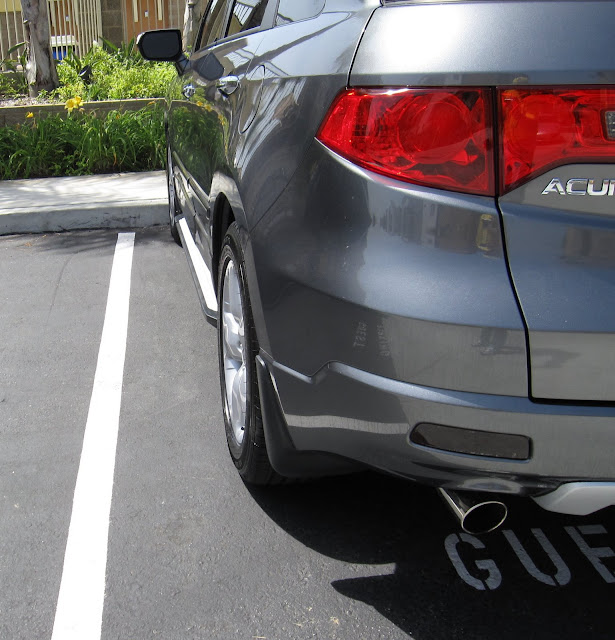

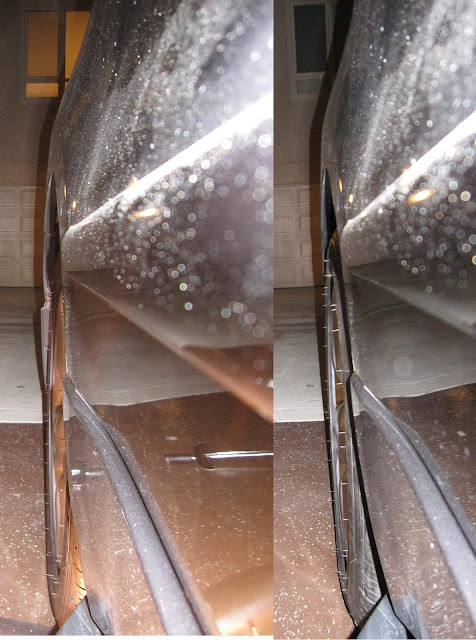

Installed the spacers today...
....they're very nice quality. Hubcentric rings fit perfectly. The nuts that secure the spacers are a bit tough to torque down. They come with a special socket similar to a wheel lock and they're a little difficult to get down tight without stripping them. I'd probably try to find short acorn nuts if I had it do over again, which I hope I don't!
I got the 15mm spacers all the way around, and I have aftermarket wheels that are 8.5" wide, so they have a bit more track than the stockers. The sidewall of the tire (255/45-20)sits only a couple mm's inside the outer fender, with the tread width even with the inside of the fender. It looks great. I'll try to get some pics up on my Cardomain site soon.
You'll obviously need to measure yourself and decide what width you want, but I'd probably go with 20mm with stocker wheels. I've used H&R spacers before, and these are just as nice. Last thing: don't order from OptionImports.com. They didn't even ship mine for over 2 weeks, after promising to do so twice earlier. I did get the spacers and an apology, so I won't totally bash them, but the service and communication left a lot to be desired. I'd definitely order them directly from Ichiba USA.

Here they are. I'd definitely go with 20mm (maybe even 25mm) if I had stock rims. The 15mm's worked out perfectly for my application.

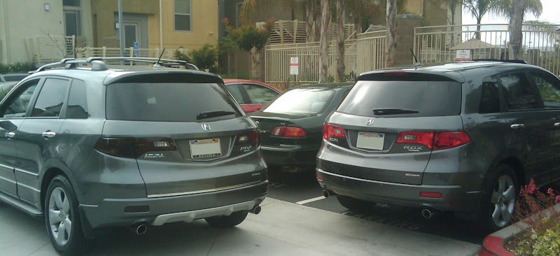

I ordered 20mm from optionimports on a thursday and got it monday. Installed it monday night and it looks great on stockers. I really hesitated with spacers since i want rims but well, if i got rims, i'd get 19's or 20's and i'm worried about the harsh ride (as if it could get worse) since my other car is already pretty unforgiving
20's are just right on stockers. its not entirely flush, maybe 25's would be flush, but depending on your tire (if it flares out) you could be more than flush (stock tires seem to flare out a bit).

20mm spacers on stockers vs stock

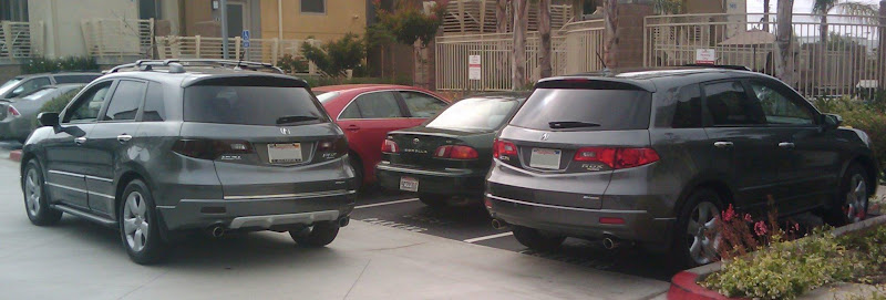

Here's a better photo

Thanks for the pics. Do you suppose 25mm will fit without rubbing?
