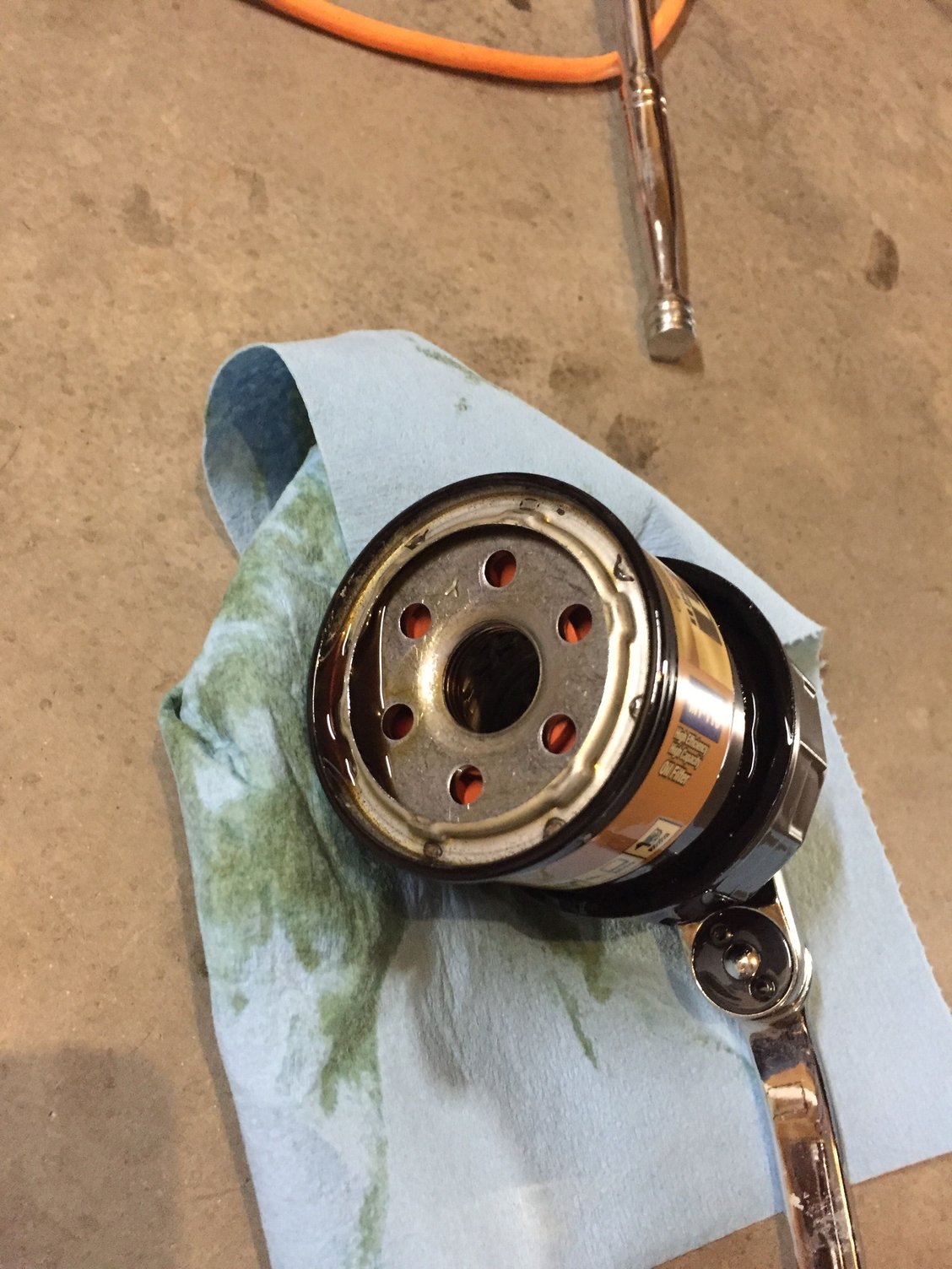

So turns out the oil filter I used did not have an O ring! I thought that it looked a little odd when I installed it, but totally dismissed it as, I'm just a shade tree oil monkey. I went back to O'Rielly's and bought a new Mobil 1 & WIX filter for comparison sake and you can see that below in the pictures. I also took a shot of the inner of the oil filter housing to see if there was a stuck O ring and the original Honda OEM filter I replaced. Thanks everyone!
Good new M1 & WIX oil filter I just bought 15 minutes ago
Bad M1 filter I used in the video's above & the Honda OEM filter I replaced
Bad M1 filter
Inside of oil filter housing

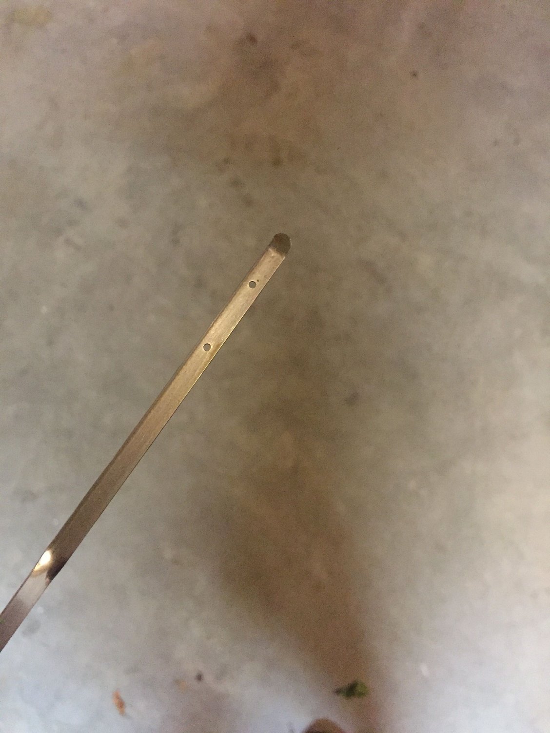

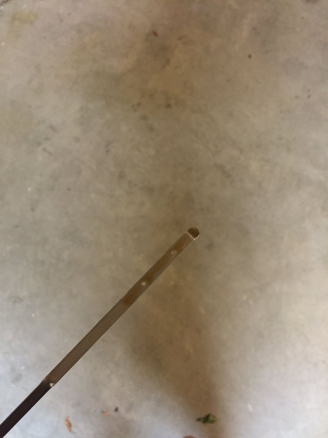

So now I'm trying to figure out how much oil I need to add. I feel stupid for asking this, but here are my current readings of a cold engine on level ground.
Side 1
Side 2

I would only use a OEM Honda filter. Takes about 4.5 quarts.
Reply 0
Nov 22, 2015 | 11:31 PM
1.5 to 2 qts.
Reply 0
Nov 23, 2015 | 09:48 AM
The space between the dots is 1 qt. If the dipstick is totally dry, add 1 qt and measure again.
Reply 0

Ended up needing to add about 3/4 quart. No more leaks.
